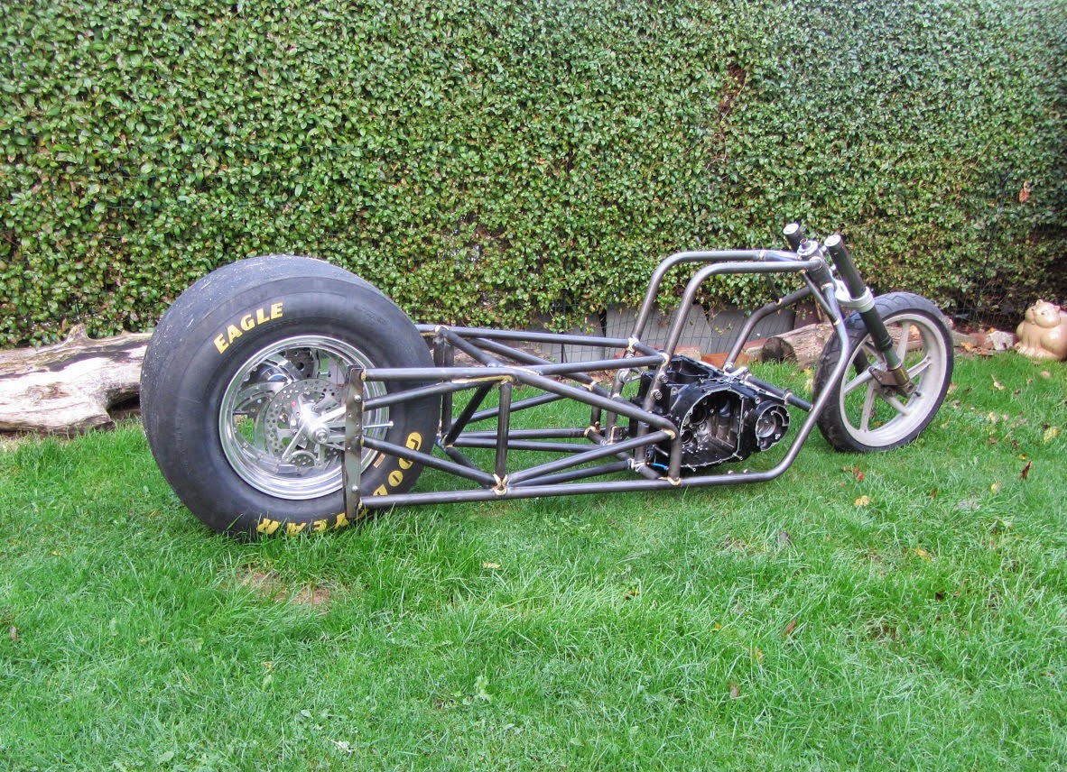

    GS based dragbike build in progress. Nitrous and large cc's
    • 9490
    So far, so good. I'm guessing from that rear Goodyear Eagle you're not planning on doing a lot of cornering.
    Waiting to see pics of the engine!
      • 35927
      On the contrary, he'll make a U-turn about every three or four tenths of a mile.

          Are those brazed welds?
          JTGS850GL aka Julius
          GS Resource Greetings
            • 10783
            I was curious about the different color of the welding material also. I spent some time studying the pic and all of the tubing.
            Its pleasing to my eye. Nice looking job.
            • Urban spaceman
              It does have to turn off the track at the end, and there's a corner or two on the way to scrutineering so it does a little bit of cornering yeah! The Goodyear tyre is only for mockup purposes, it'll have a Mickey Thomson on for the track.

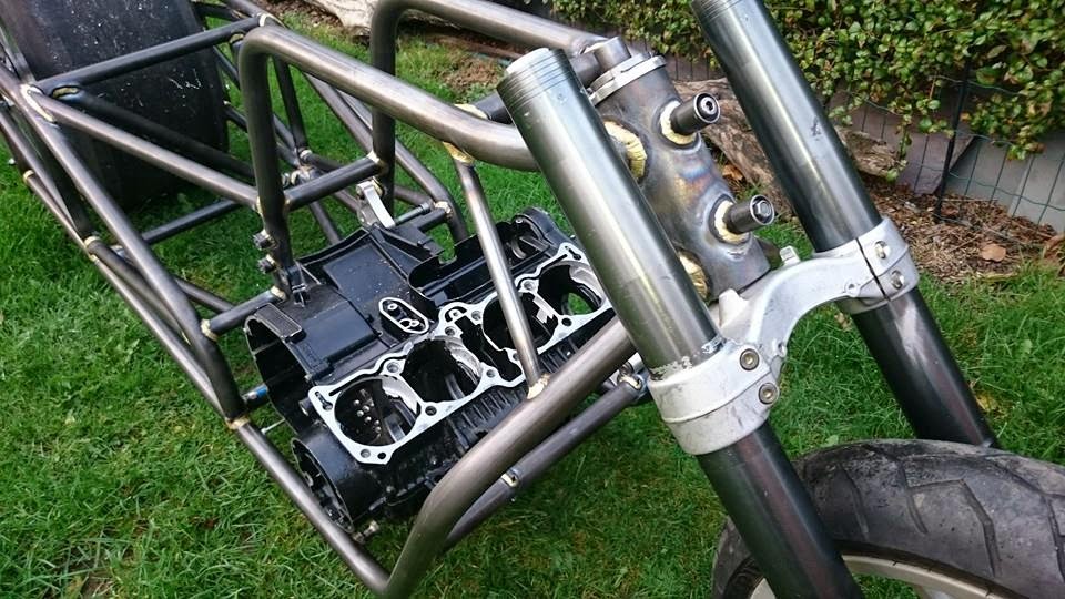

              The Tube joints are whats known as Bronze welded, or braze welded yeah. A close up....

                  When I was building racing go cart chassis, they were brazed so the frames will flex, thus becoming the "suspension" in the chassis. On a dragbike frame you DON'T want flex! I am interested to hear how this works out. Good luck, I hope this works. Great looking design. How many inches is the wheelbase, & how big will the engine be?
                  Ray.
                  • blowerbike
                    • Aug 2008
                    • 7057
                    and what is the crank to axle measurement.
                    welcome!
                    • Urban spaceman
                      I hope it works too - which of course it will!!
                      I know it in mm
                      1335mm c to a
                      2026mm wb
                      Engine will be whatever i have ready i guess, but i'm building it for a V&H 2V and 1640cc

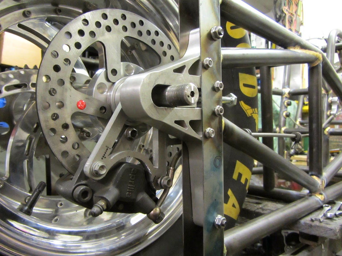

                          This build has been ongoing for a while, i started 11 months ago when i bought the tube. The pics so far have shown it pretty much as it was just a few weeks ago.
                          I have a LOT of pics from the build, it's all documented on my blog but i thought i'd share some here...... here is another...
                          • Urban spaceman
                            and this is back in july
                            • Urban spaceman
                              and a bit more recently
