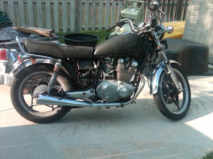

    I've decided that, regardless of future plans for the bike, I first need to bring it back to original operational configuration and ride it for a good while to see what aspects of the bike can benefit from performance upgrades. Here's a pic of the bike as received so you can see what I'm starting with.

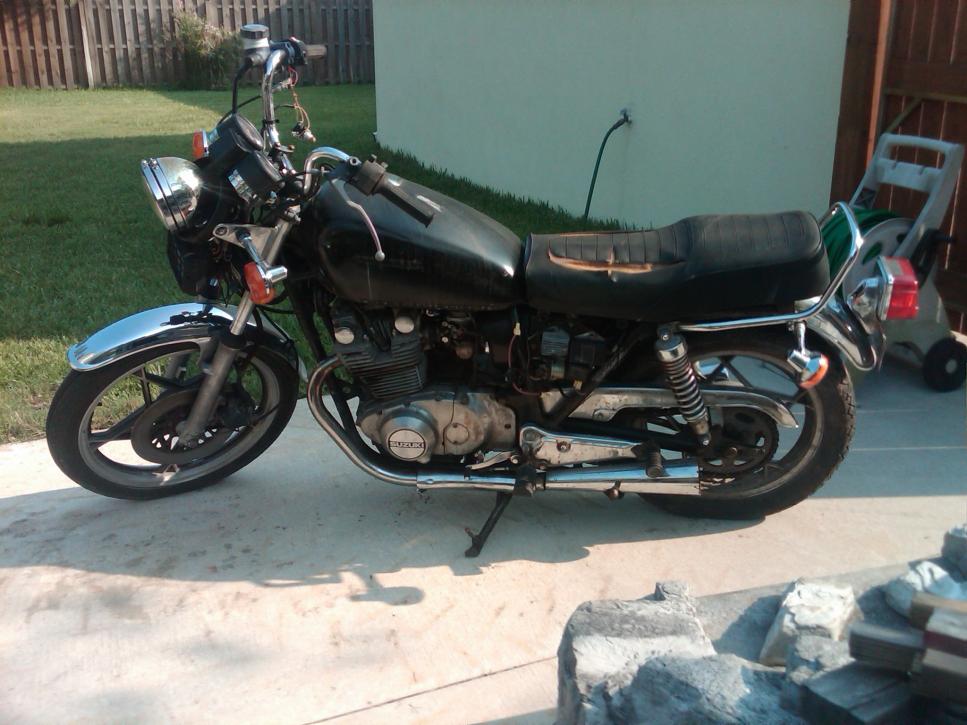

    Here's another pic...

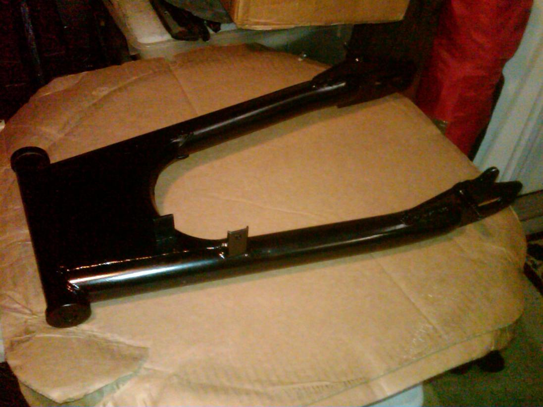

      Currently in the process of replacing all of the frame and wheel bearings, beginning with the swing arm. The left hand needle bearing in the swing arm was completely gone and for that alone I'm glad I tore the bike down rather than get it running initially. Here's a pic of the swing arm after bead blast, paint and new bearings installed.

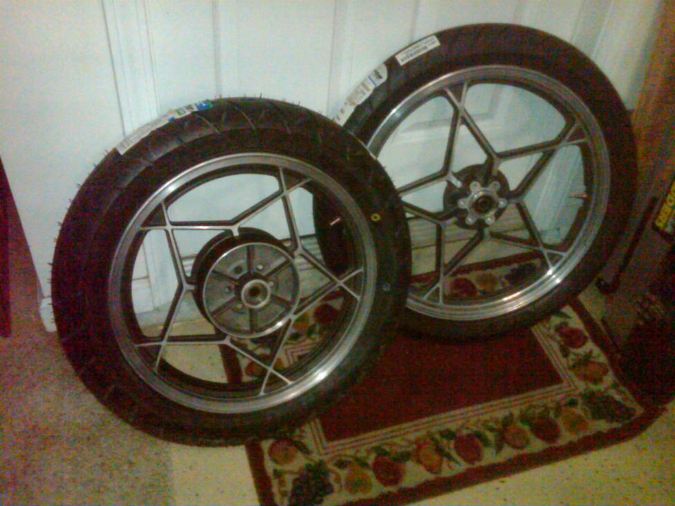

        Here are the wheels (17" rear, 19" front) after clean up and new tires installed (Durotour rear, AM26 front). Attempted conversion of front to tubeless with little success so far, so I may have to install a tube if I can't resolve the leakage issue. No success yet getting the rear bead to seat either, so batting average on tire install sucks at this point...I'm tenacious though, so I'll resolve these issues eventually...

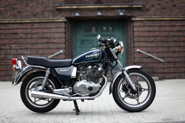

                  I agree wholeheartedly with both of you and my plan is to have it as close to original in looks and performance as possible when I'm done. The few changes I'm making are a set of superbike bars to improve riding position (for me), and I'll have to graft on new mufflers to replace the mangled originals.
                  This is what I'd like to have when I'm done.

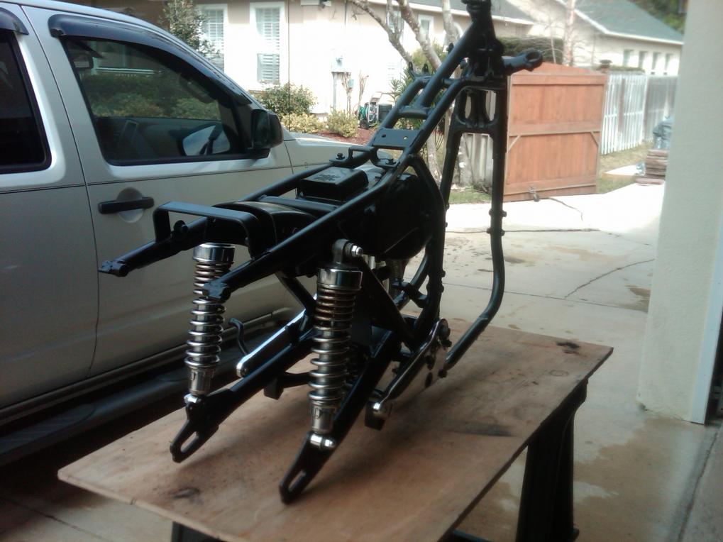

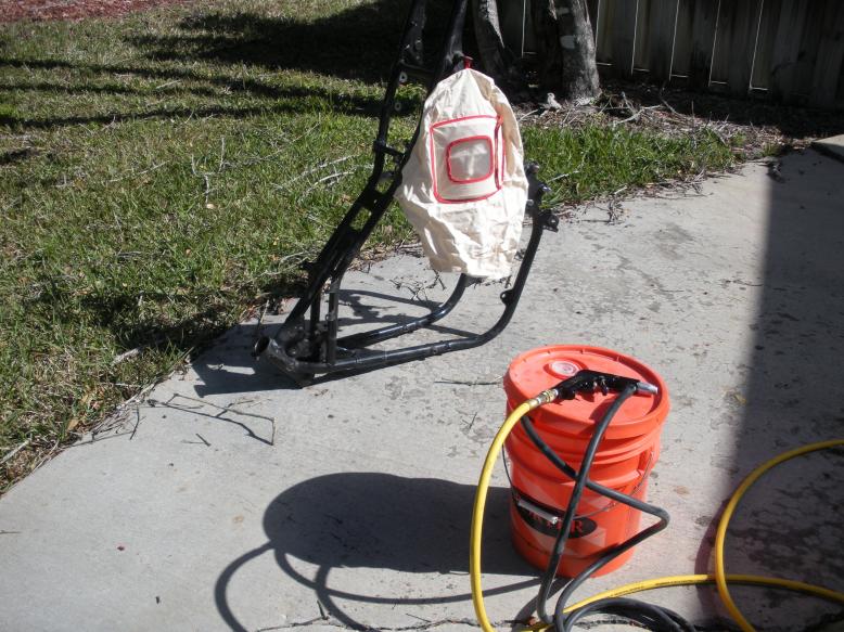

                    It was a beautiful day today in N. FL, about 70 degrees and sunny with very little wind, so i got an early start and got myself set up to sand blast the frame.

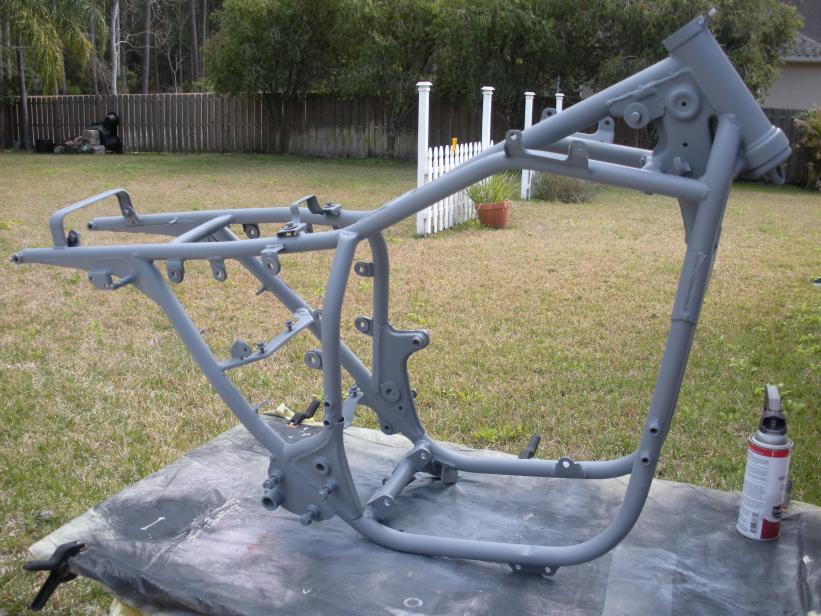

                      Then I wiped it down with alcohol and applied self-etching primer...

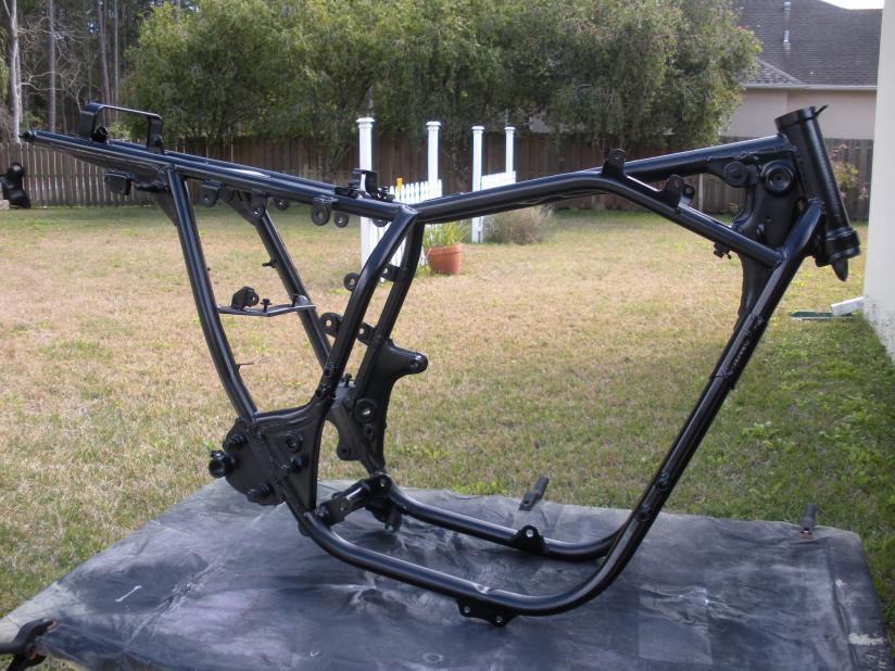

                        And finished up with gloss black chassis paint...not a bad day's work...

                            Progress update. Installed the swing arm (new bearings freshly greased) and a few other items yesterday.
                              This is where I'm at so far...
