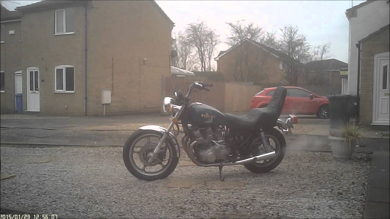

    Fired up quite easily and ran okay. All 4 pots seem to be working. Happy with that.

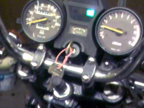

      Soldered parts of front brake switch and got it working.
      Cleaned out left hand switch pack. Areal pain to put back together again!
      NewTyre(front) arrived.
      3 Indicators arrived from eBay Germany. All look good but don't
      work,no power to them at all. Could be the indicator relay?
      Fixed the gear position indicator harness. 3 snapped wires as it was too short due to the routing. Turns out that the bulbs are okay. Oh well,5 spares on the way from china.
      Soldered up the clutch wiring too. that had been cut off and shorted. It would have been easier
      for PO to just join the wires, but no, they cut the harness. Now repaired.
      Spent a while figuring out the fuse box while experiencing brain fade
      Fitted new throttle tube and grips.
      Got all 3 indicators fitted, but no flash .Checked the relay and it seemed ok (capacitor charging and discharging) but no flash. Made a physical adjustment to the contactor arm and went too far, nothing at all. Backed it off a little and bingo. Left hand side flashes. front right doesn't because there is only one of them. Back to ebay to find the other.

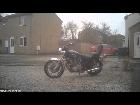

                      Everything refitted. Started it
                      up and took a run around the block.
                      Ignore the old fat man, he's not integral to the plot...
                      Noticed an improvement overall but still not right. The induction noise, combined with the knowledge that it's quite difficult to rejet these engines without investing in a dynojet kit, was enough to convince me that standard spec is the way to go.
