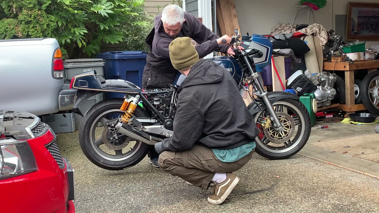

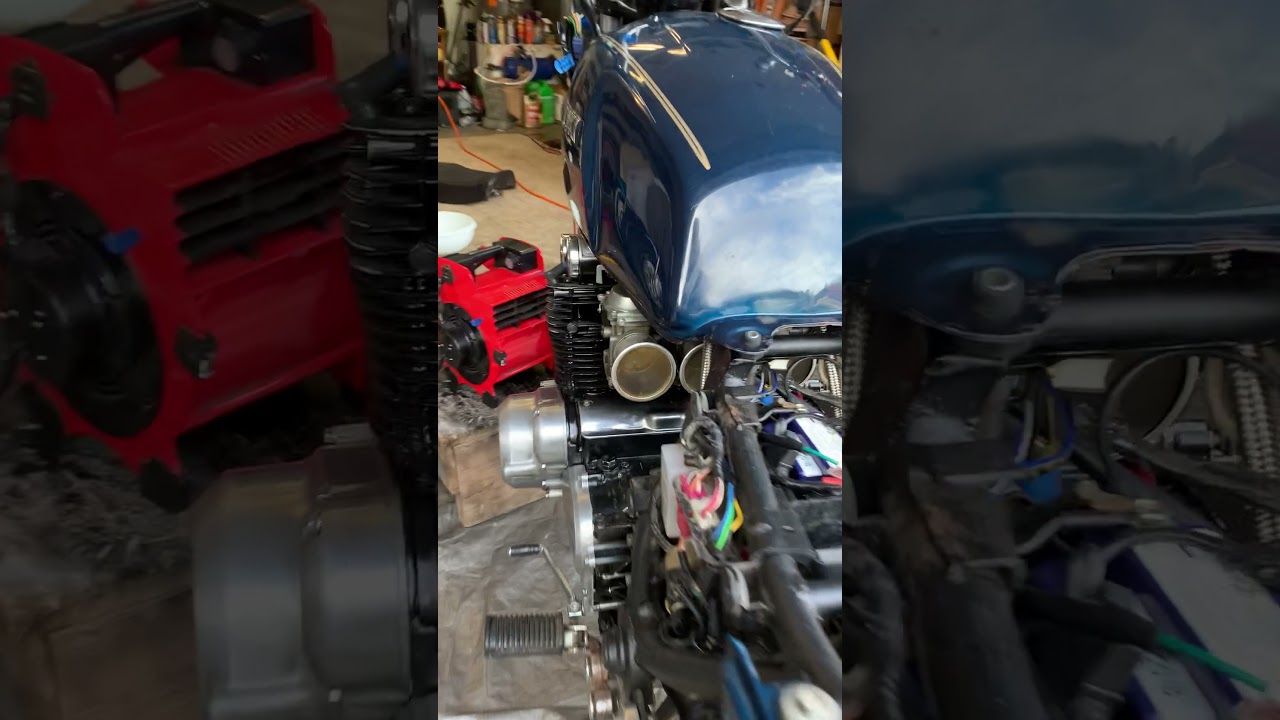

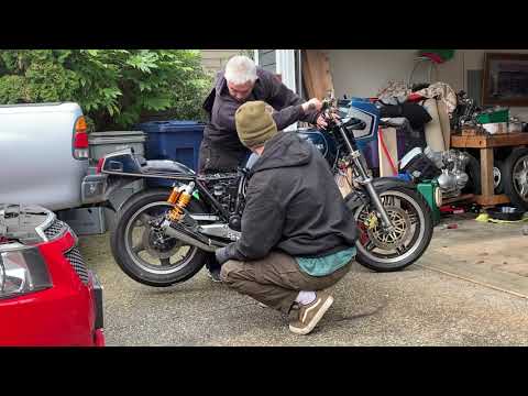

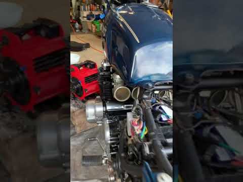

                      Today's progress report.. Fired up the bike.. Not without minor issues, of course. First, the starter clutch was slipping badly. You could hear it in the first video.
                      The second video, was after I tightened the rotor bolt, and cleaned the carb's idle ports. I still have to fine tune the jetting.
                      The MAC pipe with my home-made baffles, are loud...
                      First video.
                      Second video.

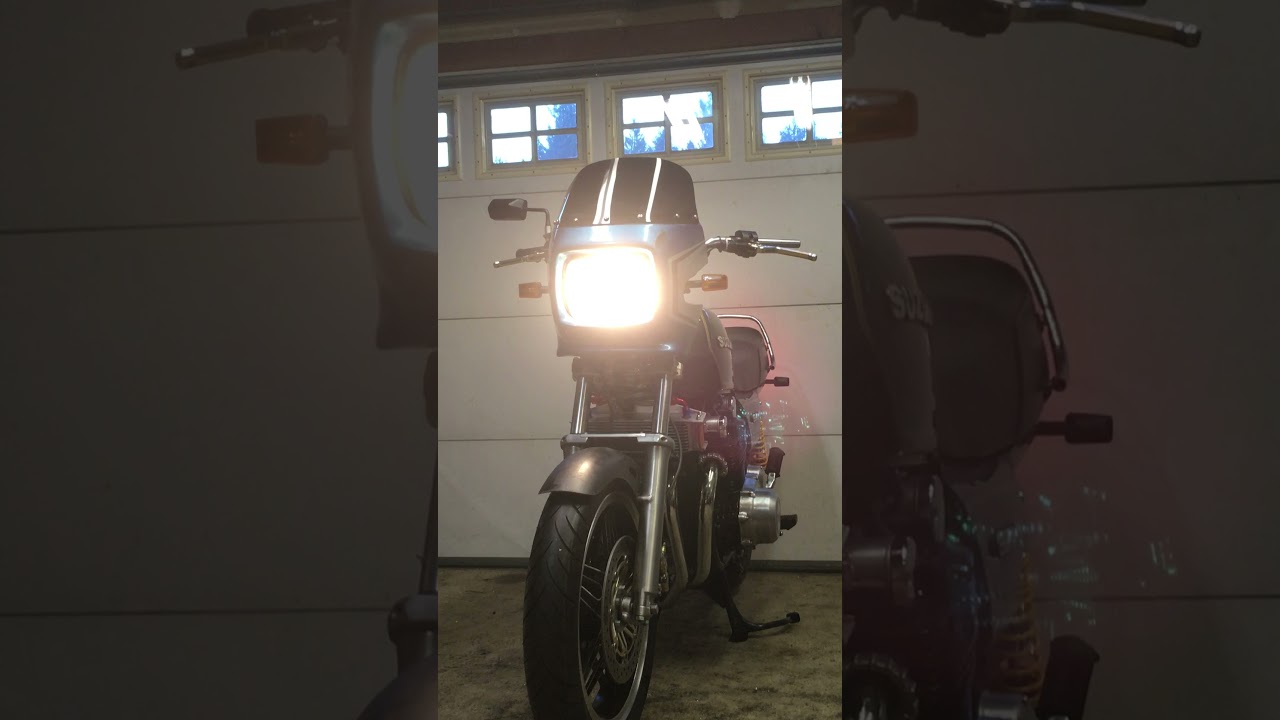

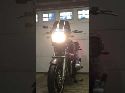

                              Almost ready for it's maiden Test Ride.. Need to fabricate a left side mirror mount, bleed the rear brake and obtain new license plate registration tabs..
                              Fabricated a fairing mount & installed the new windscreen. Installed four new mini turn signal lights.. KOSO gauge works.
