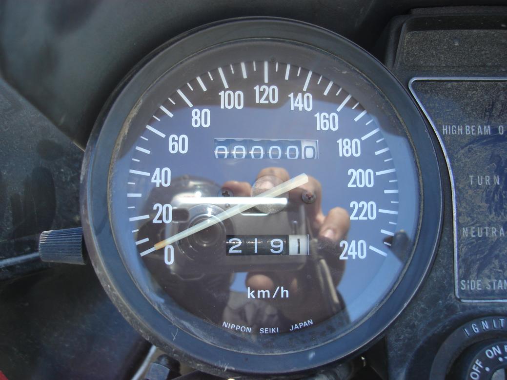

                      Well, I got her out over the weekend. This is what she looks like. I will be sure to update the thread as often as possible. I thank everyone for the advice. IMG_15191.jpg
                      • Corporal91
                        Sorry for the small pics. They blow up nicely though.
                        • Corporal91
                          IMG_15201.jpg A few more dings in it now that I remember...
                          • Corporal91
                            IMG_15271 leak.jpg The red is where the leak seems to originate from. The yellow is a spot I located with a cooling fin that seems to have been dinged off. I did not see any other damage around that area however.
