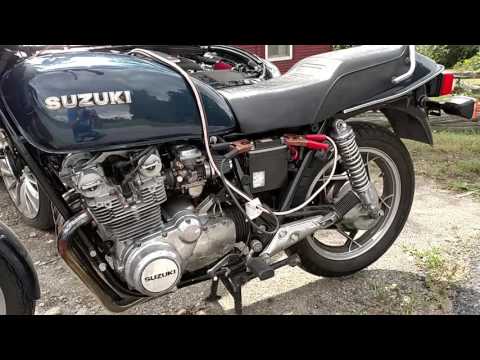

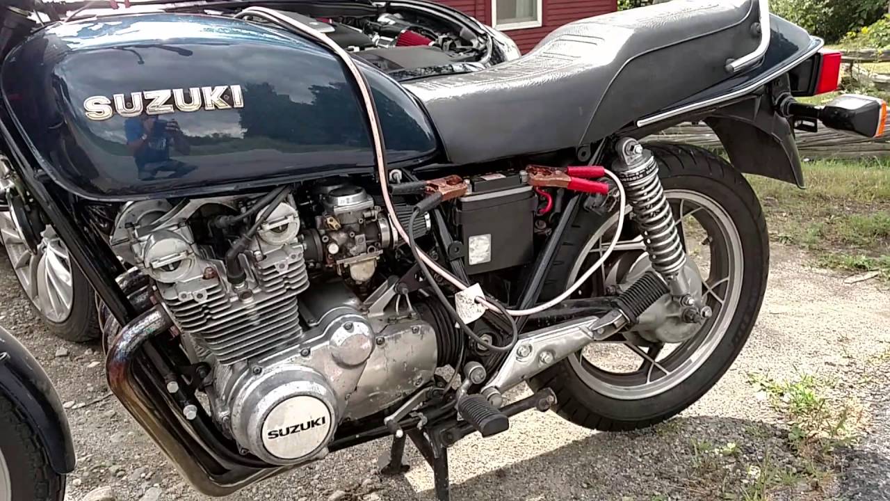

          The $200 parts bike finally showed up!
          Guy I bought the bike from told me the bike wouldn't run because the compression was too low. So for the purpose of trying I sprayed a shot of ether hooked up the battery and..:
          Motor holds idle, I ran it down the road and back. Jetting is definitely off but the motor pulls very well and leans out on top(jetting issue). Not conducive to a motor suffering from low compression which builds compression as the revs increase. Bike has allot of punch right off idle.
          So I will still use it for parts for the 550 build and my GS650L.
