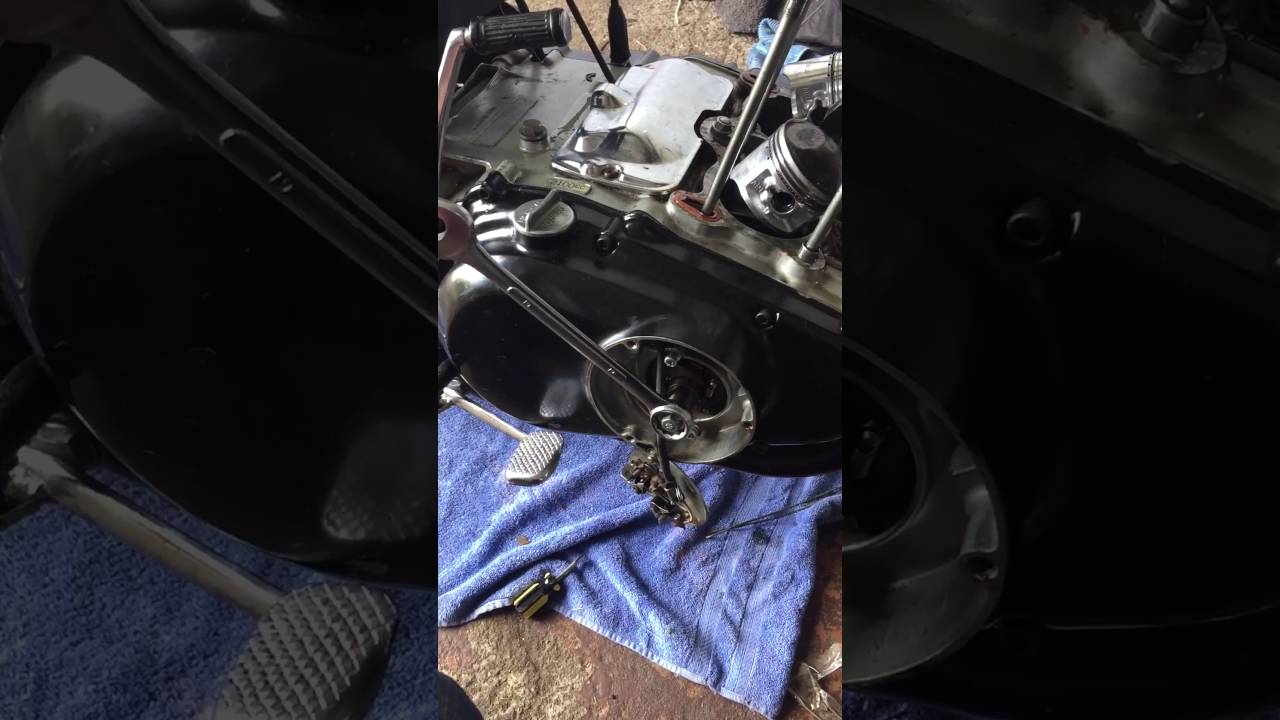

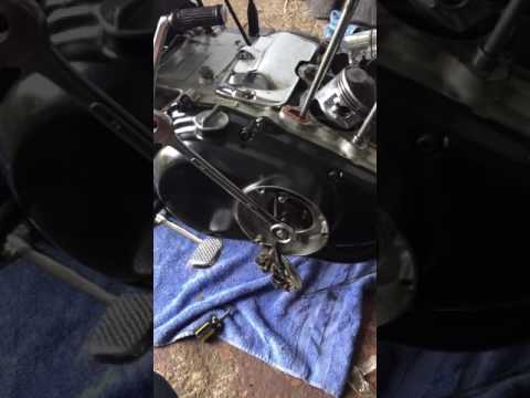

                            Well after inspection today I think I might be leaning towards new engine. As much as I would like to restore it it feels like the micahnic might be right .With both cams out its hard for me to turn the engine with the adjustment bolt.. im puttin tension on the chain so that the teeth grip it but it feels almost like something inside is warped. I'm gonna pull the head completely now and see if the problem still persists im not sure what I should do if it does.
                            • Brandon77gs400
                              this is the bike without the head on it and as you can see it snaps back and forth as I rotate the crank. I assume it's warped just based on how it feels and looks. Any advice?
