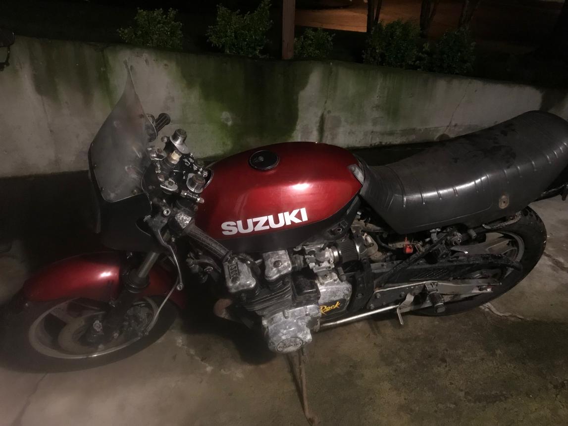

    Hello all! Posting from the beautiful (and cold) Pacific North West. I recently picked up a '83 GS750E and have begun the slow process of rebuilding. This will be a new challenge, as I've only half rebuilt one bike before, a 1981 Yamaha XS400.
    Here it is just after I picked it up. Definitely not the stock set up. The guy that originally owned it did a lot of custom work on it. Unfortunately, it has been sitting since 1990 or so, when the guy died. His son sold it in a lot of bikes to an exporter, who sold it to me for $350. Definitely gonna need some work. Here's the kicker though. Those carbs on it? Definitely not original. Definitely Mikuni VM29s, which are apparently worth some money. So I have rebuilt those and plan to sell them, hopefully help fund the rebuild.

    I wonder if any internal performance mods were done to the motor. Smoothbores, braced or aftermarket swingarm, aftermarket exhaust as well home brew rearsets and lower clipons I would think there must be some fancy stuff hiding inside the engine. Welcome to the nut house and good luck with the project. Any history on it?

      Not much history I could glean from the exporter I bought it from. He basically just wanted to get rid of it since it wasn't a classic enough bike for him to export to Europe, apparently. As I said, the guy who originally owned it and did all the work on it died this past year, and it was sold by his son to the exporter. Really wish I could know, all the work on it really seems like it was done by someone who knew their stuff. He made custom sleeves out of aluminum to put the VM29s on there. I'm sure I'll be finding surprises through out the build.

          Carbs smaller than stock, i'd bet big money, that engine is stock inside. Those 29's would work great on a stock engine.

              Why not just restor it to how it was modified way back when? It'd be a period correct "restomod"
