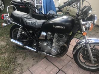

    Hi everyone, I recently purchased a pretty rough condition 850 shaft drive from my cousin for $100. The bike has been sitting since 2018 and basically before being unused it had two issues that needed addressed. 1. The engine was leaking oil from somewhere probably a gasket or two. 2. The charging system wasn’t doing it’s job. The previous owner installed a battery tender that was used while not being ridden.
    ive ridden it a few times in 2016 and it had good power and fun to ride.
    This past week I replaced the fuel lines because it was leaking gas. After doing that , still leaking gas, from the left and right carb outlets (overflow lines) and asked a mechanic friend who told me the float bowls are stuck, causing the gas to leak/unable to start. (I got it to start the day I brought it back, but then it stopped cause the float bowls)
    im gonna be gone for 6 months for army ng basic training/ait November 13th but hopefully before I leave I can get the rust out of the gas tank and probably replace the fuel petcock(should I just buy new oem?) because I’m pretty sure it’s not working properly.. and clean the carbs to stop theoverflow gas leak.

            From the picture in the first post, it appears to be an '81 850L.
            You do NOT have any 'overflow' tubes on the carbs. Those are VENT hoses. If you have gas dripping from them, do NOT crank the engine over with the electric starter. Pull the spark plugs, put some rags over the plug holes and bump the starter VERY carefully in VERY short bursts. You probably have some gas in one or more cylinders, you don't want to experience hydro-lock.

                        I pulled the plugs, put some rags over the holes and bumped the starter a few times... spark plugs smell like gas and the rags do too. Is this all I have to do for right now to prevent that hydro-lock? I only bumped the starter a few times, is that enough?
                          • 35927
                          Since you had gas coming out the vent hoses, it was apparent that you had WAY too much gas in there. It is quite likely that some of it may have found its way into a combustion chamber via an open intake valve. If you had turned the engine over with some gas in the cylinder, there is a chance that you could cause some damage trying to compress it. Removing the plugs and spinning the engine would blow all the liquid out, so you should be safe. Don't forget to change the oil and filter before running the engine. It is also possible that the gas that made it into the cylinder also made it past the rings, straight into the crankcase, diluting the oil.
