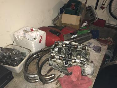

    Hey there folks. So today is the official start of what I?ll call a slow process of rebuilding my 550 Street Tracker.
    My engine stand came in so I have to make some adjustments to my workbench first, then put it all together. Hoping to get that done tonight.
    So far, I have pulled the plugs and looked into the cylinders to find the #3 piston blown up (That explains my last ride).
    So we?ll see where this takes me have to pull it completely apart and assess the situation.
    Anyway, here are some pics before I get started.
    Looks like I can only post one photo per post at this time. I?ll post more, later.
    First obstacle completed. Got the bench down to the proper size and mounted the engine to the stand.
    Next order of business is to try to figure out if I can save it. I blew a hole in the #3 piston. It figured out that this has actually been sitting for nearly 10 years. The head cover had been pulled off before going into storage. Unfortunately it wasn’t put back on beforehand. The garage it was stored in collapsed almost three years ago and it spent about 9 months in the elements.
    That being said, there is a lot of corrosion on some of the engine. The camshafts have a tiny bit of surface rust. Have not cleaned them up yet. I’m really hoping I can save this engine and keep it from the scrap yard. I have no idea yet, where to start. If it weren’t in such rough shape, I’d he k the valve clearances first to get a baseline, but I’m not sure it would be accurate with the surface rust. Perhaps I can take some fine steel wool or brass wool to the cam lobes to clean them up and then check the clearances.
    Either way, it’ll need to be torn apart to do anything.
    What would you guys do? Where would you start?

          The GS engine is very hardy, I'd be surprised if your engine couldn't be saved. I would say you have two options... the first it to clean it out & just get it running and go through a series of oil changes.
          If it were me I'd pull the sump & look at the bottom end. If it looks good in there and shifts through all the gears I'd first get it running "as is" before attempting any kind of stripdown. Change the oil a few times in succession to clean it through.
          You might need new rings & stem seals as plus some gaskets probably a worst case... obviously make sure it spins on the starter etc... Check the stator if you go behind that cover.

            So essentially, pull the head off, change the piston and put it all back together to see if it?s running. inspect everything while it?s apart.

              Looks like a fun project! If you blew a hole in a piston, I wouldn?t attempt to get it running until you tear the engine apart and clear out any broken pieces. The last thing you want is loose pieces jumbling around inside the case. Just my two cents.

                I agree, the pieces of piston are in their somewhere. You may get lucky and the pieces went downward instead of bouncing around in the cylinder. Inspect the combustion chamber and cylinder walls for damage. Since you will be pulling the cylinder to remove the damaged piston, I'd replace all the rings and re-crosshatch the cylinder walls so the new rings can break in properly. The big question I would have is what happened to cause the damage?
