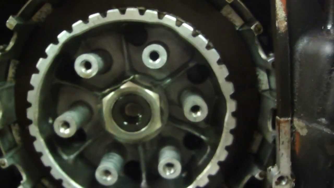

            Yesterday I started by pulling off the clutch cover to have a look and replace the gasket.
            Looked pretty good in there to me, nothing further needed here, I think. So I cleaned off the gasket surfaces carefully with a couple of razor blades cleaned up the oil sediment that had settled on the bottom, and gave the rest of the area a good cleaning before I oiled the gasket and put it back together.

                  I'd check the clutch for a fairly common issue .. the central clutch hub nut.
                  On these GSes they tend to come loose.
                  Lasts a long time when re-torqued but APE sells a stronger nut that will not loosen.
                  Rijk

                              4. Took clutch cover off again, took off clutch pressure plate, springs, plates.
                              5. Measured clutch plates as per service manual (all well within spec)
                              6. Measured clutch springs (low end of spec, will need to replace at some point)
                              7. Checked center clutch hub nut, and it was extremely tight with no visible wear on folded part of washer. I tried to loosen it but it did not budge easily, so I did not go any further. (Thanks Rijko for the tip!)
                              8. Put clutch back together, torqued, replaced cover using existing (new) gasket.
