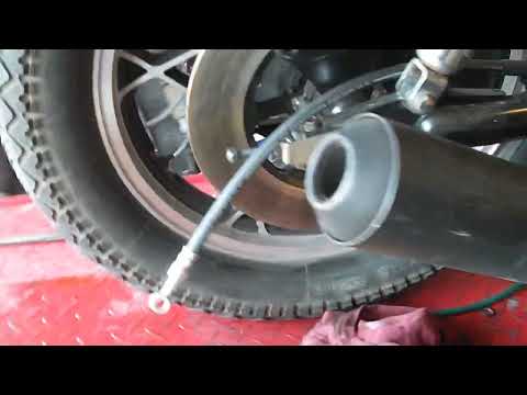

            TODAY I SMELL VICTORY!!! I hung the old school Harris 4 into 1 and put carbs on. The pipe was originally on the 80 Cooley Russel Reeves sold to Frank Z. Now it slings under the red cooley. I had the Martek leads reveresed so it wouldnt start at first. Switched the leads and choked it and it almost instantly lit off. I got old exhaust gaskets in it but new ones are ordered. Now its wire up the SH775 and buy caliper seal kits. I uploaded the video to my youtube channel so i hope the link works for everyone.

              Very nice Chuck! You know, you can embed the video right in the post by using the film strip icon in the reply toolbar and pasting the copied video share link where it prompts you to.

                            Wow, it fired up in about half a second.
                            Congrats on passing another level on the resto list.

                              I had the ignition wires to the coils crossed and had cranked it a little before realizing i had to swap them around so it was already "primed" so to say when i hit the button. Thats probably why it hit so quickly. Before i came home it had sat about an hour and it instantly hit when i tried it agan. Still need to throw a timing light at it and sync the carbs but i suspect neither sre very far off bsed on how easily it starts
