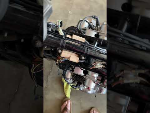

                    #39
                    Fired it up today, it warmed up in about the normal amount of time and settled to a steady 1K idle, very smooth and will take throttle with no hesitation, taking it easy though as I sort things out. And no fuel leaks.
                    There is a little bit of burbling and popping (i.e. backfiring) on overrun that you can hear when I rev it, so I need to lean it out gradually, I think, to find the sweet spot. Or something. I have the emissions mixture screw 1 turn out but I think that may be too far, from my reading. The main idle screw is about 1 1/2 at this point.
                    I hope fine tuning is all it takes. I was fearing it would be terrible with the pods and V&H 4/1 on there, but I think it's already in the ballpark. Unfortunately I can't take it for a ride until I get some new tires, so at this point there's more wishing and hoping than hard facts to go on. I didn't want to sink $ into tires (and I'm borrowing the GS1100E's battery) if the motor lunched itself on startup - you never know.
