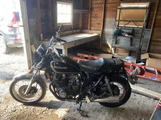

    Hello everyone, my name is Jared and this is my first ever motorcycle, a 1982 Suzuki gs450ga suzukimatic,
    I recently purchased this bike and have absolutely no experience at all on bikes, I have some experience with working on cars though.
    My goals are to get it running again, I bought a new battery waiting for it in the mail.
    I have to clean out the carbs, looking for a rebuild kit online if anyone has any idea where I can find one I would appreciate it!
    Any tips and advice would be greatly appreciated!
    I look forward to this project and meeting new people along the way!
    Thanks a lot!
