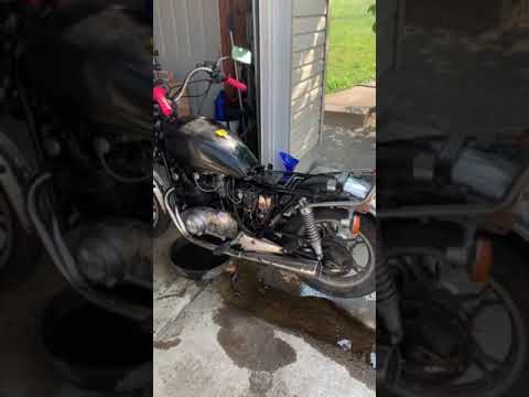

She Lives!!
    She Lives!!
    *queue mad scientist laughter*
    thanks to everyone who put up with my idiocy the past few weeks, and sorry to anyone i offended
    finally got her started, and idling properly.
    have a faulty petcock. using prime works fine. using reserve works fine. putting it on 'on' causes the bike to dump gas through the airbox after the engine stops. (not the carbs fault. those were fixed already)
    things i had to do to this point:
    strip, clean, and rebuild the carbs. one of the carbs had a broken float post, so i had to ebay a replacement.
    replace the ignition coils. one wasnt firing at all, the one that did work was shocking me and the bike every time it fired. very weak spark too
    clean out the left side case where the gear sensors and clutch pin adjustment lives. was literally caked in dirt and grease.
    fix the tail light switch and clutch safety switches. both were covered in dirt prevent electrical contact.
    figure out the wiring harness. almost everything up front had been disconnected, and i had to figure out where everything went properly.
    swap out the turn relay. the one on it look real old. like from the 70's old. got a new one off ebay, and i have turn signals now!
    change the oil and clean out the crankcase. the oil was a messed up mix of oil and gasoline because of the petcock/broken carb problem
    replace the instrument cluster. then inner bracket that holds everything together on mine was in many pieces.
    replaced the starter solenoid
    cleaned up 99% of the electrical contacts
    stuff i still gotta do
    the horn dont work. unsure why at this point. think the switch might be bad.
    one of the studs that holds the oil filter cover on backed out on me. might need to jbweld it in there
    fine tune the carbs. i dont have a manometer, so vacuum syncing will have to wait for a bit
    adjust the chain and all three cables. might need to replace the throttle cable.
    replace either the fuel gauge or the gauge sender unit. not sure which yet.
    get a new headlight bucket and headlight. was bought without the bucket assembly.
    adjust the valves and sync the carbs.
    might need a ring job on left cylinder. gonna try the MMO treatment just in case its a sticky ring
    replace the intake and airbox boots. did the o-rings, but the boots might need a swap too. unsure yet.

      oh yea. i about shouted with joy when she fired up and stayed fired up, even after i took the choke off and gave her some throttle.
        • 7680
        Congrats, we're all tickled for you. Now for the little sorting out stuff, to be expected..
          took her up and down the street a few times today. messed up by making the clutch lever WAY too tight. lost all power to the wheel for a bit and freaked out a bit. got it sorted though. had to replace the vacuum line. the stuff i had on there turned out to be basically fish tank air hose and it melted. fires right up with no choke, but that might change as the weather gets cooler. downshifting properly is kinda difficult for me at the moment. every time i shift down and re-engage the clutch, the RPM jumps by quite a bit. upshifting turned out to be a lot easier than i thought it would be, although it makes the top of my foot sore after a few shifts
