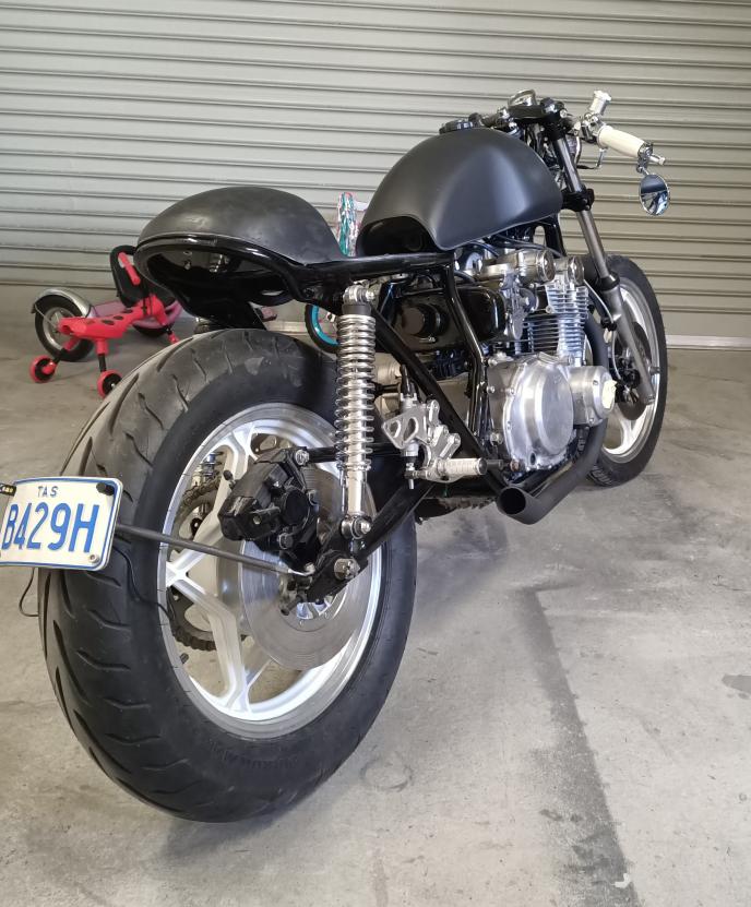

      Number plate location
      I started with I side mount plate holder but decided to go this way. Now to power up some plate lights, I've got some small led bolt type ones on the way.

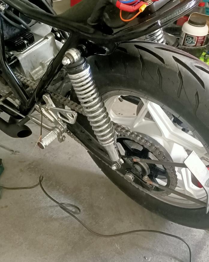

        Rear indicators.
        So the tail light in the frame loop is a brake/tail light with integrated indicators, however they aren't very clear. So I decided to add some extras on the rear shocks. These are the same ones I have on the front.

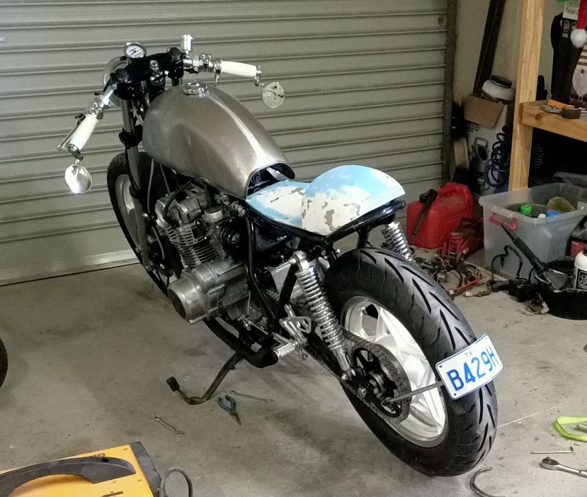

          Getting close now
          Tank and seat primed, ready for some paint...

              #36
              Mufflers????
                #37
                Originally posted by Nessism
                Mufflers????
                I'm not sure as yet mate
