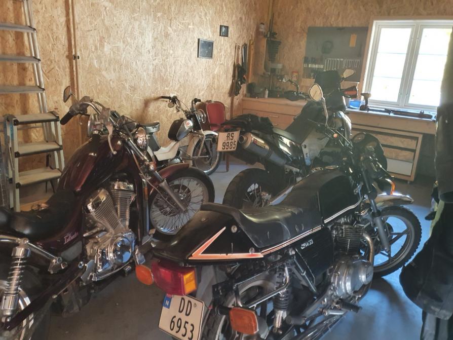

    Well. My dreams have come true. I own two motorcycles, and one of them is a project bike with good lines. The other one is a KTM 950 Adventure.
    First things first, a little background story on this GS450. It's black, and it only runs for three seconds at the time, and only with the choke fully in, and I had to remove the plugs and dry them for it to start again. Oh, and it was 8000 NOK, or about 700 Freedom Dollars. I don't have any history on the bike other than that.
    I had a few hours to work on it yesterday evening, and decided to tear into it. Tank off, start removing add-ons in the wiring harness. Heated grips that felt like marshmellows, away they go. Aftermarket turn signal/high/low beam/horn cluster - directly plugged in to a blue 6 or 8 pin connector looking OEM? Anyways. I am going to use the right cluster for off-low-hi beam and just a single button for the horn. No turn signals.
    I really don't tearing into a bike before it runs, but the electrical work was just so terrible. Re-spliced coil wires and mid-harness changes and a aftermarket headlight with all the original wiring just stuffed inside it and hacked up.
    So I decided I just had to at least fix the problems and remove the stuff that I won't keep. I have an ultrasonic parts cleaner on the way, and I will do the carbs in that. The fuel "tap" on the tank is vacuum it seems, and it was not connected properly, and someone have done some work there. Only "On" and "Res", thought there was supposed to be a "Pri" too. It had stainless allen bolts connecting it to the tank. Don't get me started on all the wrong hardware. A2, A4, 8.8, 10.9, and all with the machine bolt heads.

    Image 20210823-162732 in the Ole Jørgen Dønnestad's images album
    Image 20210824-182533 in the Ole Jørgen Dønnestad's images album
    Image 20210824-213049 in the Ole Jørgen Dønnestad's images album
    Image 20210824-214159 in the Ole Jørgen Dønnestad's images album
