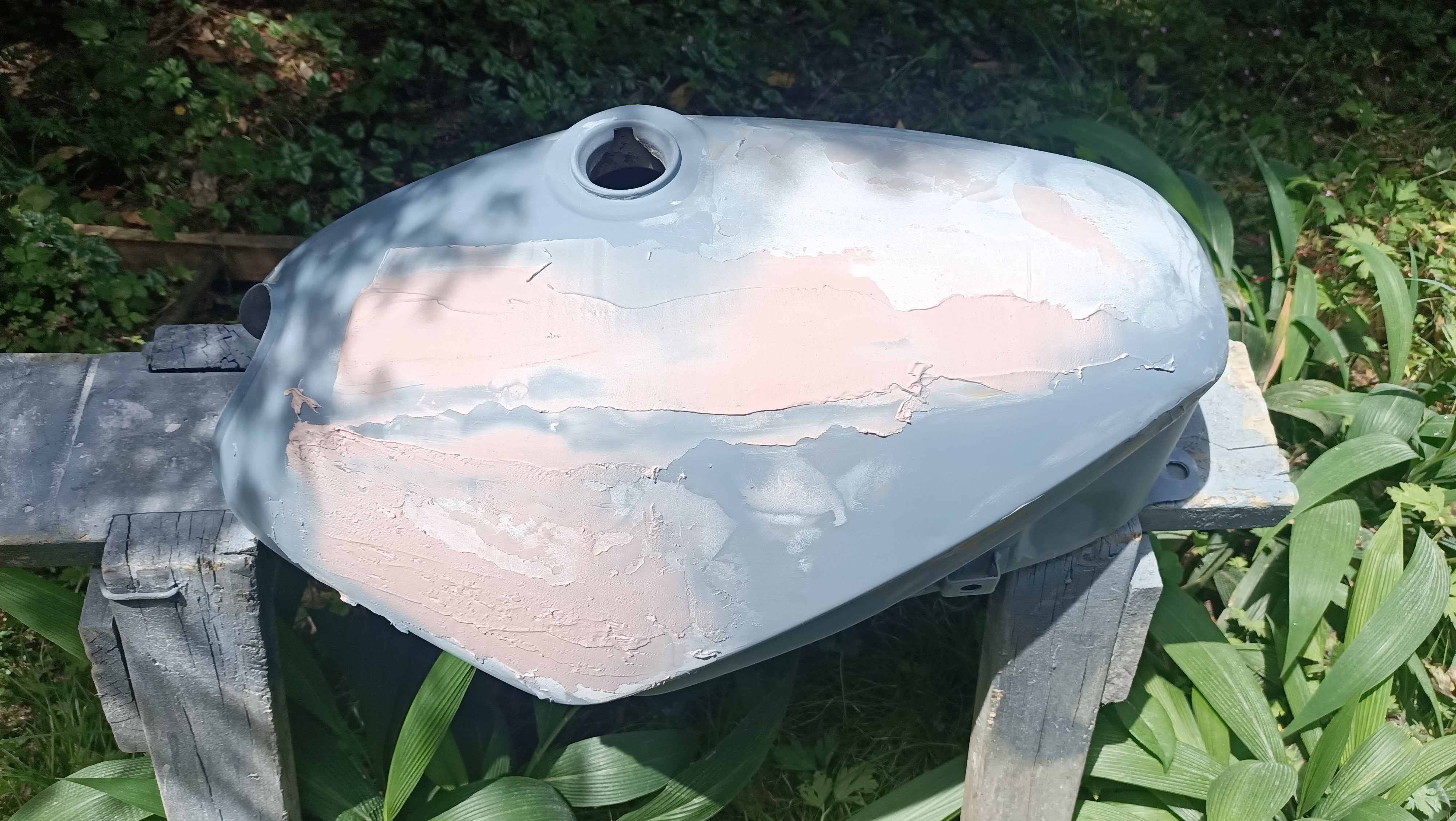

      Waiting for engine parts to arrive. So thought I'd press on with the panel and paint. The tank is pretty beat up under the filler. It's been drilled and pulled out on one side. I'll be cutting the filler back to steel to make sure there's no rust under the filler. I'll then treat the surface, lay some etch-primer and then refill, shape and undercoat.

        I cut most of the filler out, primed, filled and sanded back the tank to the correct basic shape with the minimum of Bondo. Primer filler needs to be rubbed back and skimmed and puttied in a few places. Have given the fairing a wet sand with 320 grit ready for primer filler. There is some plastic welding in the tail cowl and the side covers to do. I've not plastic welded yet, but I'll let YouTube be my guide. Got to make pins for the side covers to replace the broken ones.
