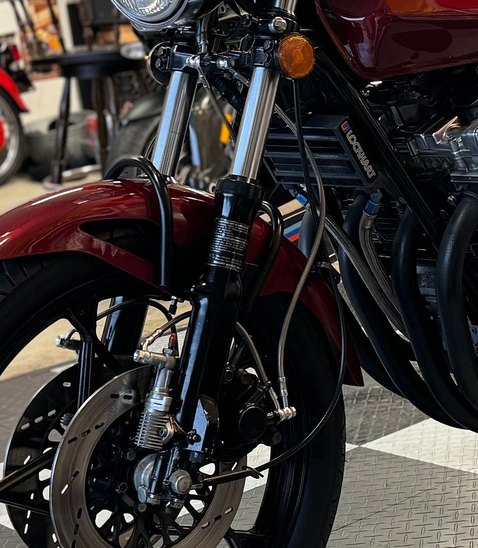

              Pic 1: Bike 1, stock MC and calipers. 20 degree bend at the MC, no bend at the calipers (pic came out fuzzy so not posted but they are just stock calipers), uses stock splitter.
              Pic 2: Bike 2, CBR caliper system with stock MC. Uses a double banjo with two separate lines all the way, done by previous owner. Funky dirty white cloth covered lines that I painted gray, meh.
              Pic 3: the CBR brakes. I just bled the system today, last thing on a full GS1100E assembly (well, no motor work). Special brackets and spacers to move discs out, no idea where they originated, might be tricky to find. Will find out how they work soon.

                  Thanks for the pics! That helps allot! I saw suggestions for running two lines from the MC directly to the calipers. Is that better / worse than doing what salty_monk suggested, running one line to the right caliper, then a loop over to the left? Also, is there an advantage to eliminating the splitter block and running two lines instead?

                    I think if you are building the lines yourself, which I've done with Earl's, then salty's way would be fine. Personally I'd do a single line to the splitter like stock, and then separate lines. It keeps all the routing simple and clean. I don't know why the PO did the two separate lines but I'm to lazy and cheap to change it, as it works.
                    There's tutorials on here about building your own. But it takes time. If you buy a kit, it should just fit and be easy, from MC to splitter and then down to calipers. Probably easiest and cleanest IMO.
