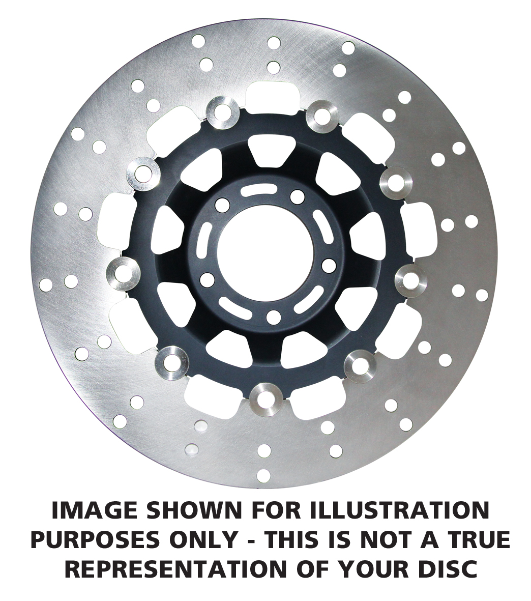

          EBC flys the Union Jack, I would see about getting a new rotor from them.
          https://www.ebcbrakes.com/motorbike/...ZUKI/GS%20650/
          You have vintage style and standard style.
          EBC Brakes Vintage Style Brake Discs (VMD3014)-Disc Attributes -Solid Or Floating Floating,Disc Type Plain,Disc Diameter 276,Numberof Bobbins 9,

                  1. I saw this at a breakers in the UK. I've contacted them to see if they can guarantee it isn't worn. At ?32+postage - It could be a bargain
                  2. The one Nessim recommended looks perfect. At ?147+shipping+import duty - It's expensive, but not as expensive as option 3
                  3. This one from CMSNL. If all else fails I'll bite the bullet and pay ?243+shipping+import duty.
