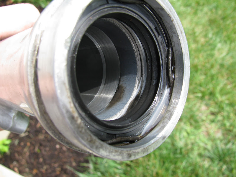

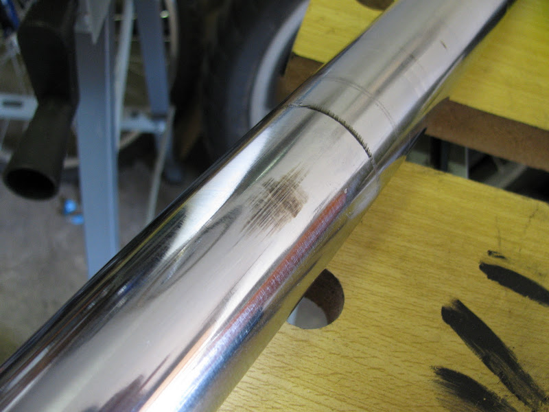

              Well, here's what I found in there. I don't remember seeing rub marks last fall when I had these apart. My project thread only shows pictures of gouges in the outer tubes. I can't feel this with a finger or wipe it off. I haven't tried buffing yet. There are matching rub marks on the Teflon-coated ring, and a spot on the bottom of the stanchion is very polished-looking. I may have done that polishing last fall to clean up gouges on the bottom of the stanchion.
              Both legs show similar symptoms. I'm guessing I didn't do nearly as good a job as I thought getting this front end put back together and aligned. Or is this sort of wear typical with the hoop-style brace? The width of the hoop would need to be correct to a tolerance smaller than the minimum clearance in the two fork legs. If I designed a fork brace, I wouldn't try that.
              What I don't get is that the stanchions are sticky within the tubes with absolutely no external load. In fact, they're only sticky when the seals are engaged with the tube. In other words, it's the seals doing the sticking. I think what I'll do is put it back together without the hoop brace and see how that behaves.
              Are some seal brands more slippery that others?

                How did you get it apart without removing the retaining clip and seal? And washer in-between?

                    ??? On these forks, there is a screw at the bottom of the fork leg that threads into the damper rod. This is the only thing holding the stanchion in the lower. The seals don't interfere at all with removal. Except for some stiction.
