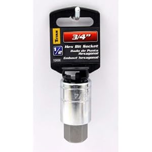

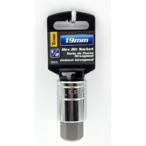

                      or get this for $6
                      Why do I find it funny that the 19mm costs a buck less?
