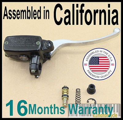

14mm piston. Good for single disc but not dual.Ed
KZ750E Rebuild Thread...http://www.thegsresources.com/_forum...0-ResurrectionComment
For a twin brake model I would use this one... (in fact I do use this same one!)

I've used this exact unit Shark, on two bikes, both twin disk, works really well, good firm feel, minimal lever action required.

Suzuki specifies a 5/8" master for dual disc bikes. Using a 14mm master with dual discs will require more lever travel than with a 5/8" (or 16mm) master (spongy feeling lever). There are quite a few new Chinese type 16mm masters available from ebay these days, so you might want to have a look around before purchasingEd

I replaced my OEM m'cyls with New Old Stock XJ900 ones years ago - nominally the same bore, but much better feel. I've rebuilt 18 months ago, and it's been fine, but notice I'd be just as cheap buying a brand new one with a free rebuild kit thrown in.Dave
