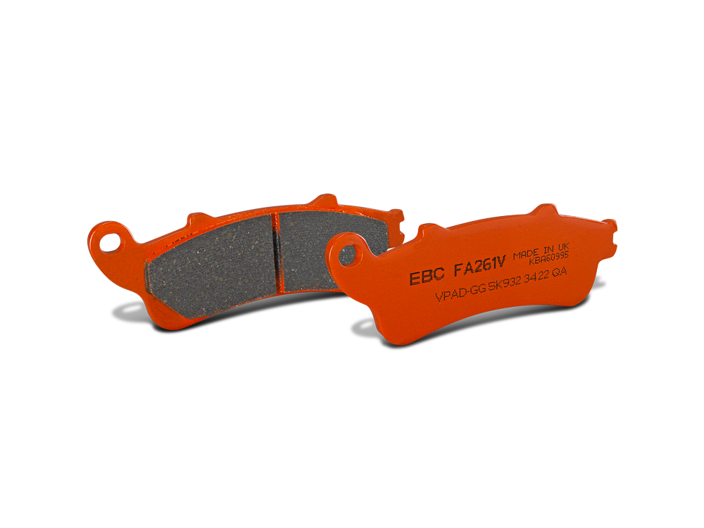

    I've replaced my front brake line with stainless and the pads with semi-sintered pads. They're very fade resistant, but what I'm realizing is that they're usually not hot enough to be as effective as I would like. I use the bike for commuting to and from work, and it's mostly just a quick shot onto and off of the freeway.
    It might be that a single disc just won't grab that hard. Or it might be that these pads need to be hotter than I'm getting them. They're EBC FA65V pads.
    EBC V-Pads™ Semi-sintered™ Touring Bike Pads by EBC Brakes product page. Manufactured from E391, an asbestos free, organic, moulded friction material.
    I honestly don't care how long they last or if they generate much dust (though lots of dust tends to mean lots of noise). I'm happy to replace the pads every 10,000 miles if it means they work great in the mean time.

                  Well, typically I do a bed-in procedure, but these say on the back that the way to bed them in is not the incremental stops to get them nice and hot like with semi-metals, but to "ride easy on the street for 200 miles".

                    They are afraid of getting sued. Try heating them up a bit. Drag the brake lightly to get it fairly hot, then squeeze harder to do some moderate braking. Don't come to a stop, just slow some. Not hard braking, this can ruin new pads. After a few of these it should work a lot better.
