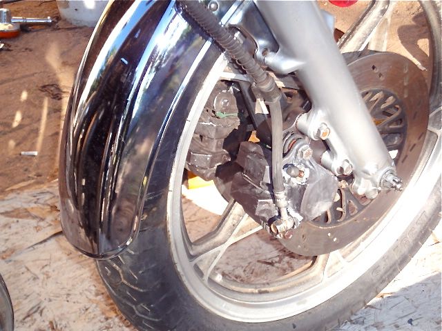

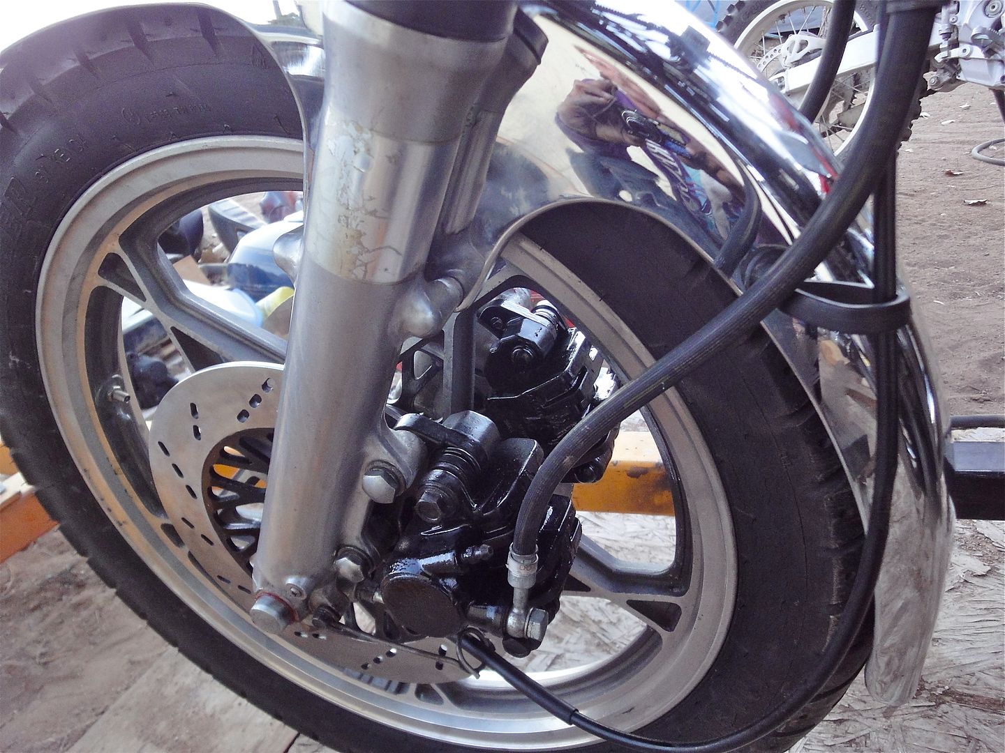

              Sent to me to share:
              Instead of just adding another rotor (you actually would need both as the single disc is larger), you should also go for a pair of '80-'81 G model calipers not only because the pads cover 30% more surface area
              than the early '78-'79 pucks, the calipers are also superior and cheap to find ($50 for a pair) besides bolting right up.
              You can increase the braking even more by getting some new GG rated pads to replace the crappy stock ones too.
              One of my '78's with those installed...
              And another one of my '78's with '83 1100E calipers (also found on '81-82 GS650G's )
              Eric
