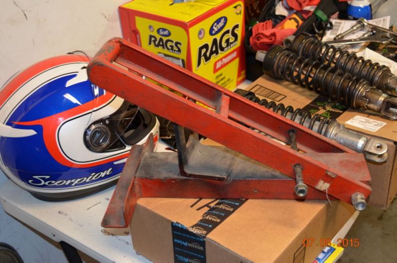

                    Borrowed a homemade spring compressor and pulled one of the shocks off my bike to experiment with.

                      There is a nut securing the dampening selector in place. It should be interesting finding out how to remove it without damage.

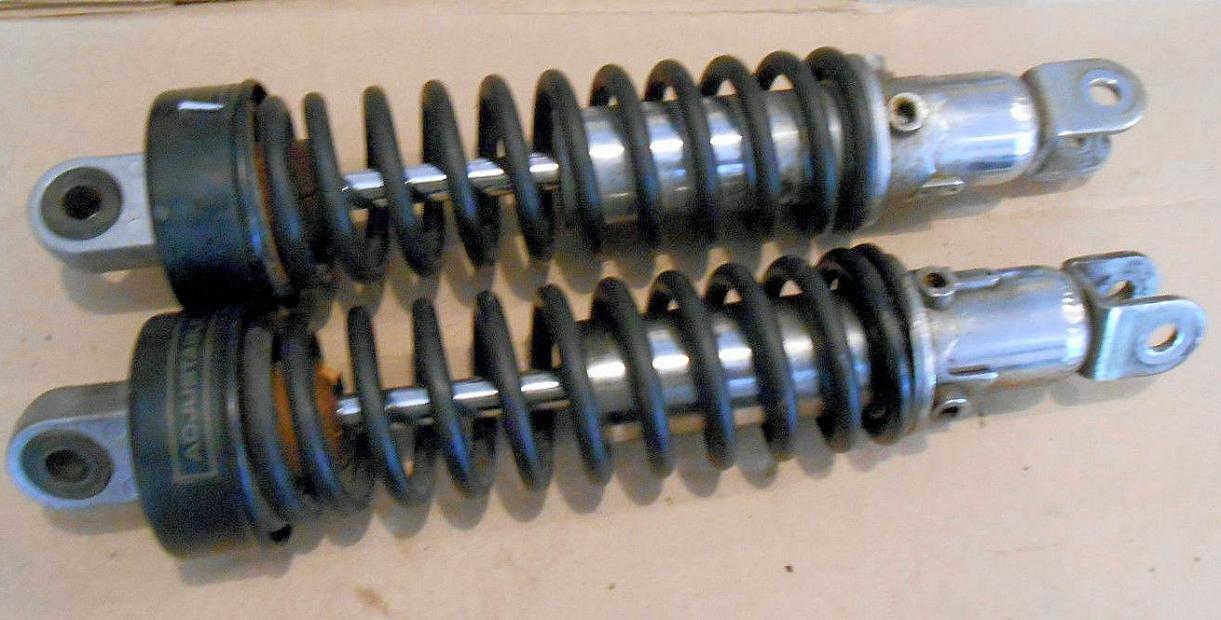

                        Today I made some progress with the shocks, I hope.
                        I experimented with one of the shocks I pulled from my bike to learn how to do this.
                        Got it, it's not that bad when you've done it once.
                        The process is:
                        1. Compress spring and place a 17mm open end wrench around the retaining nut.
                        2. Turn head of shock (the dampener setting unit) counter clockwise a couple of turns.
                        3. Compress spring a little to take tension off of the head of the shock.
                        4. Turn shock head by hand counter clockwiseuntil removed. Watch for very small spring and ball nearing that may drop out.
                        With the shock off my bike I was able to pull the stem upwards to get an idea to see if it worn out as the piston stem was badly corroded.
                        Then with increased confidence I remove the spring from the first shock I purchased for eBay.
                        When I pull the piston stem I suddenly hit oil! It came from the top of the stem. In the pictures you can see I lost most of the oil. The piston stem has a tiny O-ring that I assume keeps the oil in the shock and keeps the stem from coming out.
                        This did not happen on the first shock I tried, in fact I was not able to remove the stem.
                        Next I removed the spring fro the second shock I purchased from eBay, being very careful not to do anything to disturb the rod in the stem. See picture of shock, looks good right? Well I had no sooner picked up the shock after taking the picture when the rod in the stem shot up like a missile and with it most of the internal oil.
                        Assuming that the O-ring on the rod is to keep everything in place any idea of what oil I can use to replace what has been lost and how much I'll need for each shock??
