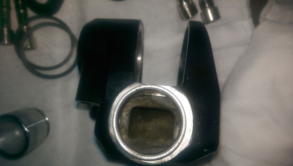

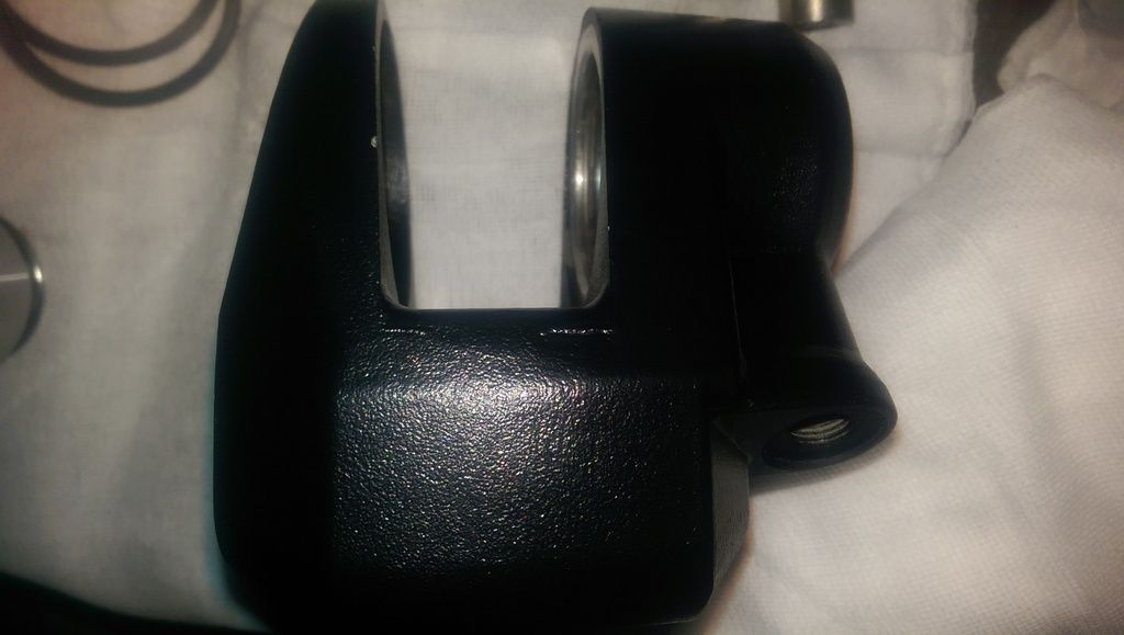

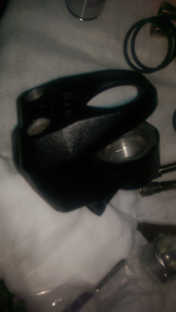

      hi Cowboyup, thanks for replying. here are some pictures of the caliper in question[IMG] [/IMG]

        Which seal are you having issues with? You'll have one that sits down inside a groove within the piston chamber (59307-45020) and then the boot that sits at the top of the piston and is pulled over the top of the caliper.
        • yossarian
          Both of them. The seal diameter is 3mm too big and won't fit in to the groove in the chamber. It just gathers up too much once it is about three quarters in. The boot is the same. It seems to fit on the piston but won't fit in its groove in the chamber as its diameter is also about 3 mm too big
