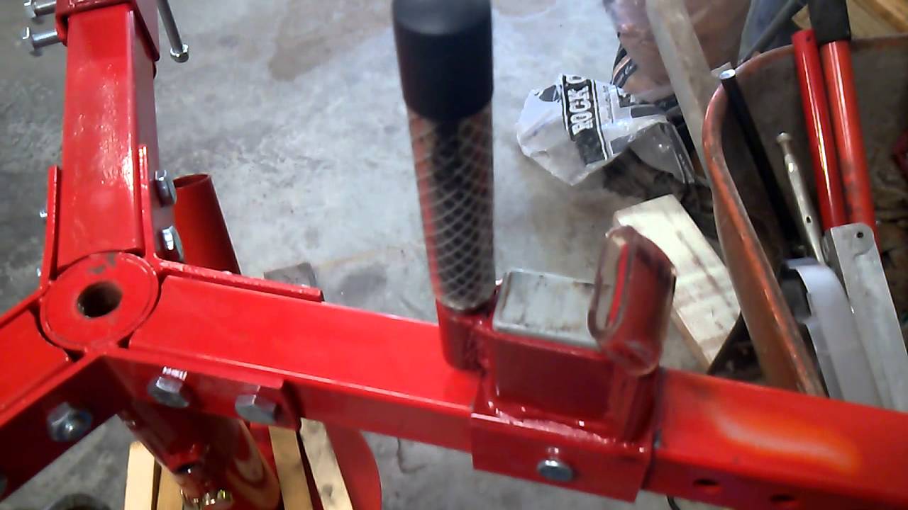

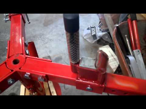

                          • 5807
                          I gave up wrestling with tyres on the floor, or buckets (which helps, but isn't really high enough) and made this last year..
                          Along with the HF-alike auto-tyre changer, I've been dancing the dance of the one who never has to pay a tyre monkey again.
                          I'm my OWN TYRE MONKEY now.
                          It was a long time coming, and man, it feels so good.
