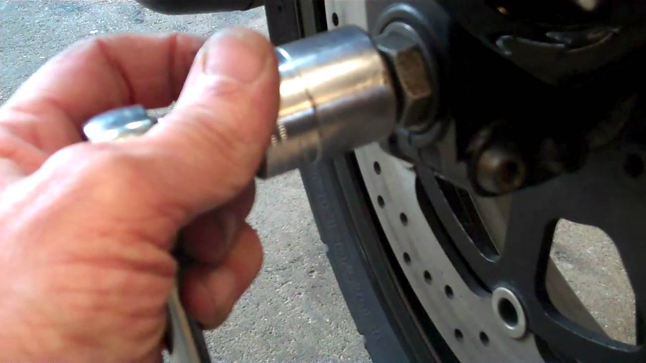

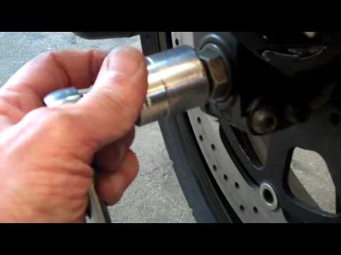

      I just saw a video recently where some guy that posts on you tube from across the pond, search Delboy's Garage. He did a process to straighten the front end by loosening the axle pinch bolts followed by loosening the lower triple in order to bring things into alignment.
      Hope this helps you. Just go to youtube and search Delboy's Garage.
      Larry

        I found it by searching Delboy's Garage front wheel alignment.
        Larry

          Found it, thanks for the video link Larry.
          It's very possible that I didn't loosen the front axle/axle caps when I was trying to set them straight so I'll give that a go this weekend when I get a chance.
          I like the `pushing down' method. Obviously havn't tried it yet but it makes sense.
