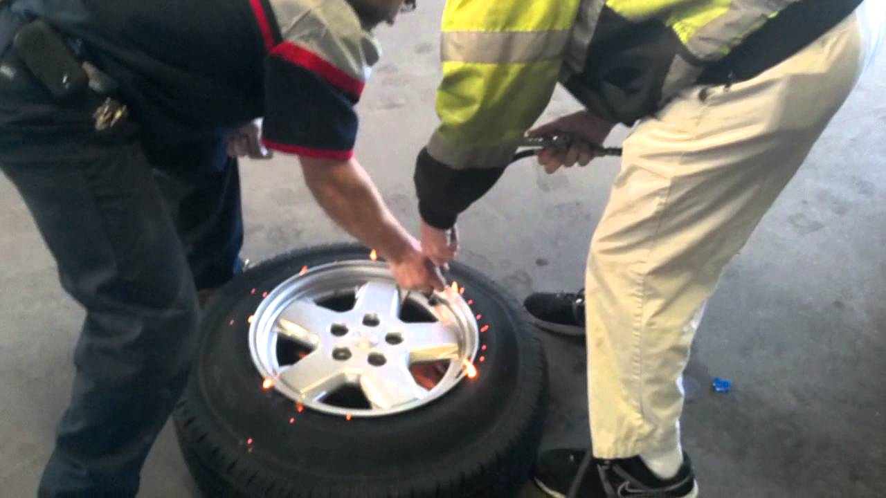

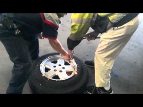

        This:
        Really. Off road guys do it all the time with their 44s

          HA!!!! I thought this was a Mexican method?
          Really looks effective to me!!! (Wear safety glasses!)
          BTW I have the same bike, wheels and Shinko tires Joe, and have forgotten how many I've put on myself. I usually just carefully position the tire to cover where I hear air blowing around the bead.
            LOL, good video.
