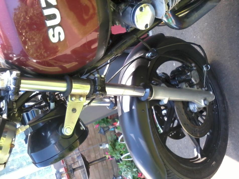

    Now I'm thinking the front forks are wrong, but cannot find any specs for GS850 fork length as a complete unit. I have forks with the air cap and length is 800mm (31 1/2") from axle to top of clamp by handlebars. Axle hole is to the front of the forks and about 100mm from the end of the shock. It also appears to have no notch for the speedo gear to slot into to hold it steady.

    1: Is this a 1979 GS850GN front fork to start with (fork seals correspond to GS850 Models ie:37x 49mm)
    2: Is the measurement of 800mm about right (or should it be about 900mm if the axle was at the bottom of the fork)
    3: If mine isn't correct, does anyone in the UK have a decent (ie: correct) set for a 1979 GS850GN they'd be willing to part with (for cash or swap)
    4: Which modern forks will fit with minimal fabrication (ie: use same wheels and maybe same brake setup)

    Those forks sure look like they're from an L not a G.
    If you look through a parts diagram and then go to someone like these guys that have a cross reference tool, It should tell you what other bikes used that part. Maybe just a google search with the part number will bring up other bikes that used that part.
    Looks like the fork for 79 is unique to that year according to the cross reference on this site, but 80 and 81 are the same. Whether you can swap the entire fork from one year to the other I can't answer.

      Thanks for the link - looks like I do have the L Front Forks.
      Does anyone have the stock measurement for 850 fork assemblies (axle to top)
        Leading axle forks, an 'L' mudguard and slotted discs all indicate that you don't have the original set-up.

                Thanks for the replies. I have now sourced and fitted a G Set of forks. Length from axle to top of clamps is approx the same at 800mm ish. Looks like the PO used entire front end from the L as I am now looking for brake spacers/new calipers to bolt on.
                  This is the front end now.
