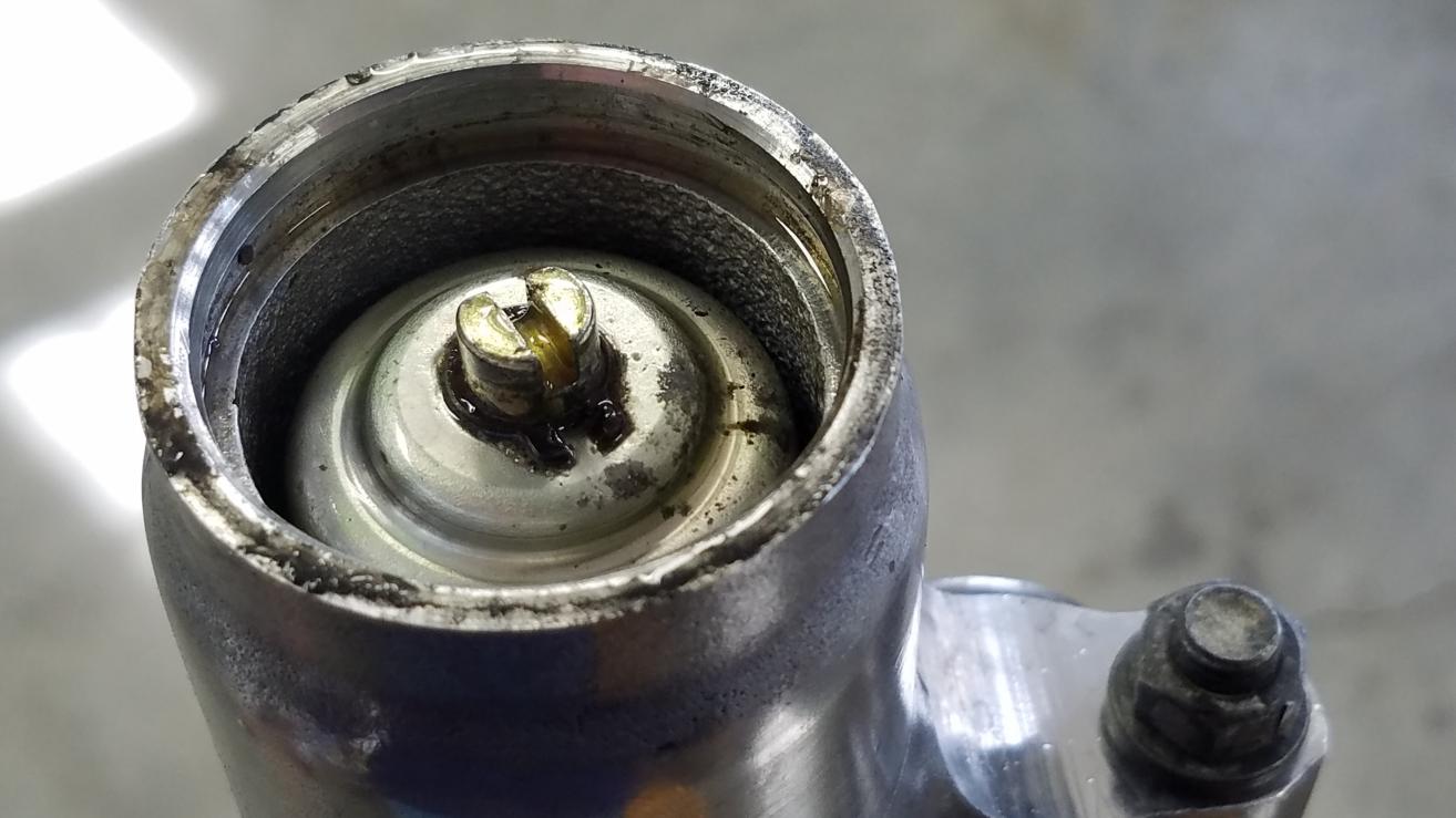

    1981 1100e fork seal replacement and Sonic spring install next on the list for me. Very first question of probably a few if I may. Oil drained and top cap loose but not removed. This bottom clicker must come off to expose a bottom bolt does it not? How should I go about that task without damaging it...does it pop off? I for sure dont want to force it without knowing for sure!

          I would rather disassemble the forks that way I can inspect and clean everything thoroughly. I just cant seem to find anything on the net or in the Clymers manual that I have on how to do so on these adjustable bottoms I have with the clicker adjustment knob on the bottom of the fork leg. Surely someone has done this style? There has to be a way to remove this knob to get at a bolt head of some type.

            ah, i see Droberts has the info you need-still:
            found this on CMNSL could be the clue you need. I see the knob anyways. Otherwise get a different shop manual than clymers here at BikeCliff's Website.
            I didn't see the knob but there are addnedums per model...you probably want the 80-83 GS1100-LT-LX etc...one. Yours would be the "EX" I suppose
            ✓ access the FRONT FORK schematic ✓ find Suzuki FRONT FORK spares easily ✓ OEM parts online available
              Thank you soooooo much for this info! Exactly what I have been searching for, time to get busy!!!
                Originally posted by D Roberts
                https://racetech.com/page/title/DRod%206-2%20KYB%2037mm I think you will find exactly the information you are looking for.
                PS.... Do not be concerned re my low LoL post count.....Purged it a few times since October 2006
                I would have never found this, explains to a T!

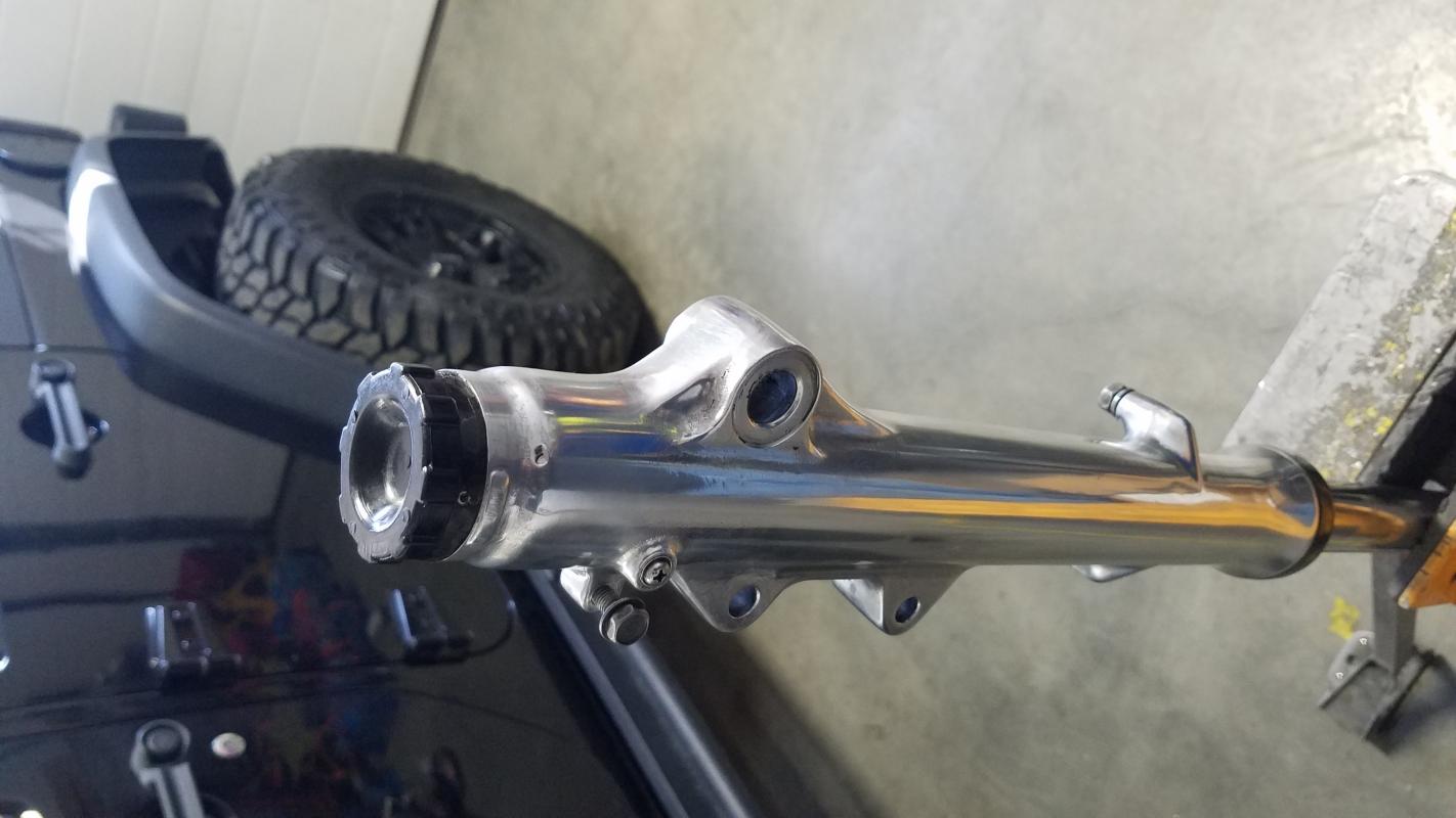

                    I have read about that method here but mine have no shrader valves on the top caps. I have one done and tackling the other now. I figured I would do both seals and dust caps then the Sonic spring install on both. So far the biggest fight was that little damn snap ring going back on under the adjustment cap but it finally submitted. Have the other in a pb blaster bath while I eat lunch.

                            Now that's one I have not heard but would like to try! I just finished not forks minus the fork oil. Taken apart, new seals, retaining clips, dust covers, Sonic springs and spacers as well as some time taking apart the fork caps with preload adjuster screws and cleaning the internals on them as they were quite gummed up and not free moving....I figured I would mount the forks on the bike then pull caps and springs to add oil at that time. I dont see any other way to do it with the air crossover do hickey in the top tubes and the holes in each top tube that the set screw and oring go into when mounted. Am I missing something here???
