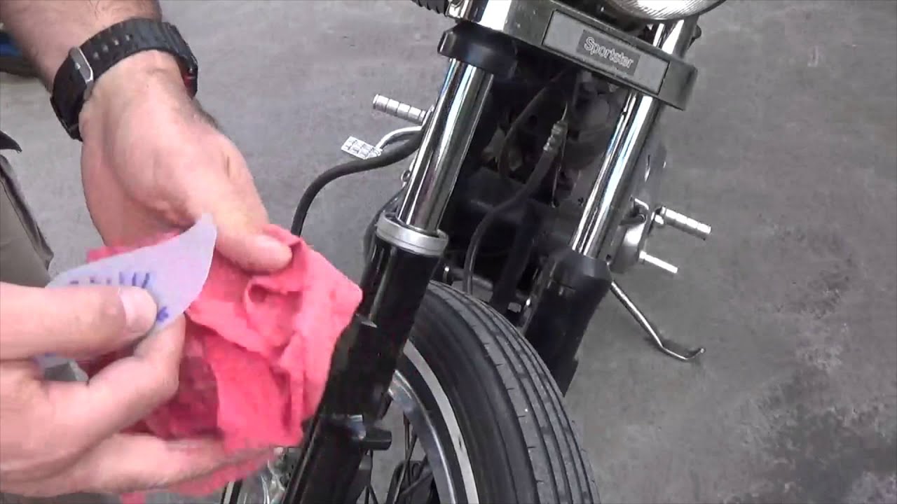

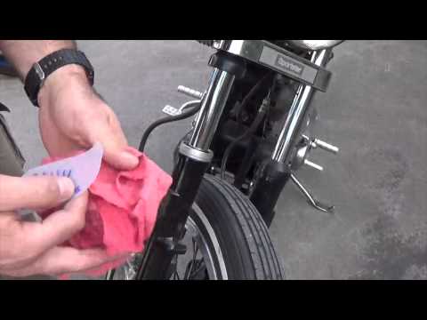

                        You can try this for a temporary fix.... I used it one time and it worked til I got around to changing the seals.....
                          likely the video I saw.
                          tough to trust a 'viccy' of course ... but it did work for me once!
