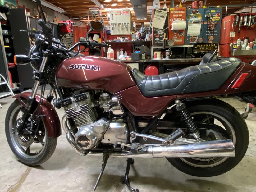

    ISO front braided brake lines for 82 GS 1100E. I just want the three line kit because I am eliminating the Anti Dive. On ebay they have the 5 line kit. they said the only way they sell them is with the 5 lines. Anyone know where I can buy just the 3 lines?

          APex in Canada seem to be well thought of... Z1 Enterprises sell the Goodridge ones...

            I use Raymond at Apex...good value and service. All you have to do is tell him what bike they are for and he has the measurements....he's done all my GS bikes.

              Yes, lots of options for brake lines. If you are removing the anti dive as recommended by race tech. You can go to a 2 line system straight from your MC. I also recommend upgrading the mc to one from a sv650s or Kawasaki. A modern mc plus ss brake lines with ceramic pads minus antidive will give you a noticeable improvement.

                I used a 2 line set for a 1200 Bandit and simply plugged the lines in the anti-dive units with a shortened banjo bolt. Been working fine for well over a decade now.
