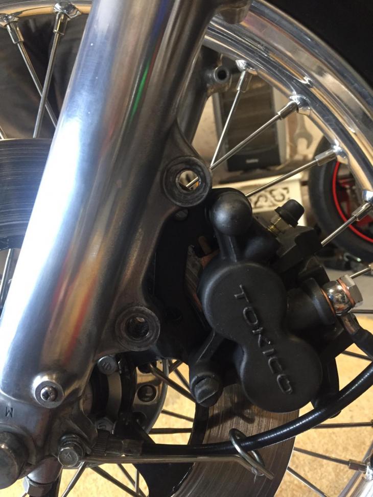

                    15160418450000836fd4a8895f30e by Dennis Harland, on Flickr
                    My take on the salty monk twinpot upgrade. Small steel bracket between fork and caliper carrier. I use a Bandit 12 master cylinder.

                          The new style bracket already fits the SV caliper... I'm using them now. They are also on the V-strom and the EX650
                          Your stock master will work. Single brake model are usually 14mm piston.
                          If using it on a single brake model you need to use a Disk from a Honda Blackbird.
                          We used a simple strap bracket in the early days as UK GS NUT has done but it's not totally safe as you're relying on the torque on the bolts only to stop it rotating around the caliper. It's meant to be triangulated back so that can't happen. I'm surprised you can get a kosher MOT in the UK with it like that.

                            I'll just leave this here.
