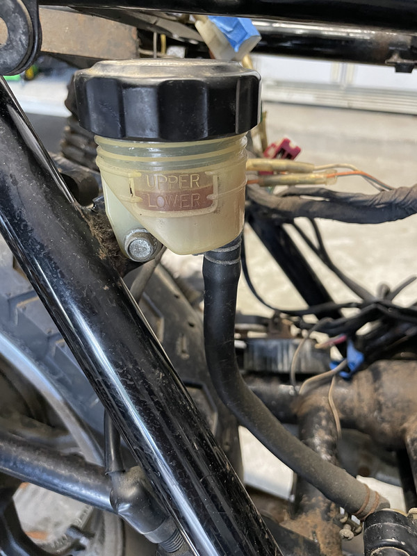

    The front brake master cylinder or the rear master cyl:which one is not pumping-out the fluid ?
    Do you have any close-up pics of the master cylinders ?

      Well technically fluid hasn?t come out of either MC when I tried to bleed the brakes, but the front MC resevior is empty, so I just assumed that there was no brake fluid in there (probably a naive assumption). There was no pressure in the system in the front (no resistance when I pulled the brake lever in),
      The issue is with the rear MC

              If there's resistance (pressure) on the pedal, there's pressure somewhere. Start farthest away & work backwards. First open the bleeder, if nothing then loosen the banjo bolt on caliper, if nothing there loosen banjo on MC...Just say'in, you are keeping pressure on pedal while opening bleeder ain't you??

                  There is no baseline when the brake system is full of sludge.
                  As Rich stated: remove calipers, pop out the pistons, pull plunger out of mater cylinder, clean everything out and consider replacing seals (and the pistons and master if the bore is corroded,) and replace brake lines which are also full of sludge which can't be cleaned.

                      The problem with used 40 year old master cylinders is there is often corrosion inside which causes pitting in the body rendering the master useless and not suitable for rebuilding.
                      For a 650 you need a master with a 5/8" or 16mm bore. You can find tons of options on ebay. A late model Kawasaki EX650 master is a good target, the version with a mirror threaded lug, because they are relatively new and not subject to as much corrosion. Or, get a generic master. The cheap chinese masters are okay since a master cylinder is a simple device. Needless to say you should inspect the bore of your existing master before assuming it's bad. Same thing for the calipers; you need to remove the pistons and look for pitting and corrosion. If you have damage and want to replace the seals get OEM Suzuki parts, not crappy aftermarket parts like K&L which basically suck. It pays to stay close to home when it comes to brake system parts. For brake lines, check out the Earls line thread here on this forum. Making your own lines is cheaper than most prebuilts and the parts are made in USA and high quality.
                        Have you tried this yet ?
                        This is a good way to trace the problem.The master cylinder itself may not be pumping but that will be determined(at the end)by this procedure.

                          Just completely remove the bleed screw and see if it or the caliper are plugged. Often the bleeder screw itself is plugged.
