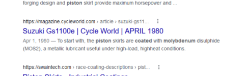

But I realized today during parts cleanup and inspection that these pistons were coated from the factory. The coating is uniformly gone from all the pistons except in the wristpin region. Otherwise they look pristine.
Can anybody tell me if this is a problem for these motors? The coating seemingly very thin, thinner than the armorglide on the latest wiseco (and other) pistons.
And an internet search doesn't reveal any info on the (GS coating) subject. Or the armorglide for that matter.

The stock pistons were not coated. Can you post up some photos?
You might want to measure out of round, taper, and piston to wall clearance. No more than .0010" out of round or taper allowed. Piston to wall clearance is less important; the manual states that .0047" is the service limit. As long as the specs fall inside these numbers, I'd run the engine, regardless of piston coating.
thank you for the reply, and see the attached. the gentleman who sold me the GS750 gears and oil cooler mentioned this in passing as we discussed other aspects of my build. but he recalled that it was on later models only..
I will take some measurements this afternoon. but the original finish on the piston is still discernable.
