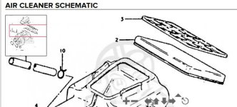

I note the mesh goes above the air filter - as per diagram i attach
Q) what holds the air filter in place ? the ones for sale on ebay are simply foam (i think)
So how can it stay in place ?
q) i attach the right diagram for my bike.
Is then item 2 (the filter ), stiff ? hence not a floppy piece of foam ?

From your photo, you are missing the plastic shelf which sits in airboax. The foam filter element sits on this and is held in place by the white plastic grid in your photo. I'm sure I've got a spare and a motad 2-1 exhaust. I'll have a rummage over the weekend. The only problem is I'm in Kent, so postage on the motad may be a bit much

Can you post a picture of the shelf as it is not a part listed on cmsnl. The grid is listed as Holder No.2 so it would suggest there is a holder no.1

Mine has never been right and i had to order the mesh you see inside.
Now there should be mesh inside and on the top of the foam filter.
I am going to order another mesh and just use two of the ones you can order !
the one in the pic is the one you can order.
I found a page in my gs250t owners manual which shows two frames that the element fits into, but this frame does not appear on any of the parts lists on cmsnl web site...

All i know and with what you have found, if you order one of these grills (i think i ordered
the only one available which i think is the top one) it will do for the top and bottom !
I have the one i ordered simply holding up a peice of foam i cut to size. it worked fine !
