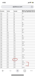

thanks... i can't believe it was able to run as well as it did for years with such small main jets in there.
in regards to track day tuning, i decided last year to retire the GS from track service, but it's replacement, a 1989 kawi ex500 ninja, had poorly timed issues (first, a CDI box, then a water pump seal) that made me have to bring the GS to the track for the first two track days this season. now the ninja is rock solid, and i have done one track day on it. it does have a tach on it, and it took me the first half of the day to realize that with an 11,000 rpm redline on the engine, i need to keep the engine at 6500+ through corner exit if i want to have any real drive coming out. and dont shift until 10.5k! it was a whole new way to ride an engine (never ridden a two stroke), and after feeling how well that parallel twin pulls higher up in the RPM range, i am frightened and excited about how much i was absolutely missing by riding the GS too low in the power band, and being about 10 sizes too lean on the main jets.
