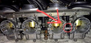

Not quite sure what it's called but the metal fuel tube that connects #3 carb to the #4 carb is leaking on the #4 side.
Assuming there's an oring in-between there and it got damaged when I ultrasonically cleaned the entire bank of carbs.
I'm guessing the entire bank of carbs have to be separated to replace the oring or is there an easier way? And does anyone know of the part number for it or an oring kit that would match?
Check the carb rebuild tutorial linked in my signature. All questions will be answered.

Cycleorings.com has always been the place to get orings for your carbs. Bowl gaskets should come from Suzuki. Ed’s procedure has that information and we have preached it constantly.
