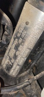

The only identifying marks are the Australian compliance plate, frame and engine numbers.
However I am at a loss as to which model it actually is.
The compliance states it was complied in August 1983 and the frame (and compliance number) are
GL51C xxxxxx. The engine is an L501
Can anyone help me identify which model this actually is as I have been searching and reading the internet for a few nights now with no definitive answer.
Thanks
Sorry for no photo, i had one on my phone but couldn't upload it. Had to wait until tonight when i could get on the computer. Anyway here is a photo of the old girl, i hope someone can give me an answer. Also if someone knows why its marked GL51C as i can find no reference to that combination.
attachment.php

Thanks for the info guys, In Australia we still require the same VIN stuff as the rest of the world however this has the Australian Compliance (approved to ride in Australia ) and a frame number of GL51C-101xxx. 3 digits short of a vin number. There is no vin plate anywhere on the bike that I can find.

That is the VIN. The missing prefix would be JS-1 which means Japanese motorcycle. G means multiple cylinder,K 399cc to..I can't remember, 5 means 4 stroke blah blah blah.
You want to go online and figure it out. Suzuki.org link above has some vin info somewhere
