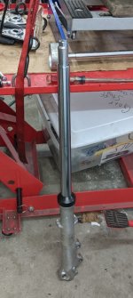

As the title says, some of the GS 550/650 models have forks caps that are held in place by some form of clip rather than a threaded bolt. The 650 service manual only shows threaded caps and the 550 service manual just says "remove the clip" and the note underneath is illegible in my digital copy. How do you remove the clip? I can't see any circlip holes like those found in brake master cyls. and I don't want to pry the plate off and damage anything.
I searched the forum, but there were tons of hits for "remove GS650 fork cap". I want to change the oil and add some pre-load spacers making reliance on air pressure less important.
Pic for reference.
