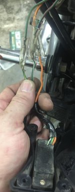

Looking for help on wires from gauge cluster 1982 GS450GA
  • Start date Start date
G
Guest
Guest
I've figured out what all of the wires coming out of the cluster are except these ones. The only diagram I can find is for a GS450 (not the Suzukimatic) and it shows the Green/Red wire being for the 6th gear indicator, which this bike does not have. Any ideas what it could be? The two wires coming out of the middle part are Green/White and Green/Yellow, and I can't figure them out either.
I'm thinking one of them might be on a switch somewhere, because the sidestand light is always illuminated when something else is. Much dimmer than when the sidestand wire is connected, but still illuminated.
Thanks for any ideas. I'm rewiring the whole bike with the X21 from NWT Cycletronics and I'm trying to figure out where these guys go.

I only have an "Owners" manual for these 450 GAs I think they have neutral indicator lamp? That might well be the Green/yellow stripe. OR possibly OIL light.
Green/White is "likely" kickstand light, looking at the diagrams I have for various 450s...Too bad there isn't a shop manual for these online somewhere.

Click image for larger version  Name:	IMG_8875.jpg Views:	0 Size:	62.8 KB ID:	1707623 I dug deeper.
The GR goes to the GW which routes from the headlight to the warning lamp assembly mounted in the turn signal / High beam assembly

maybe this photo is better.
where my GR goes to the GW from the parts diagram
