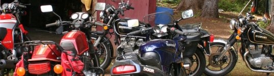

(Oh! stevemurdoch I didn't think anyone would see it in the herd! Yes, it's very likeable. I'm trying NOT to kill it :) )
