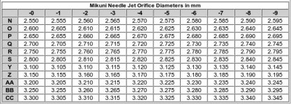

Mikuni list the needle jet range for the VM26SS carbs as N-O through Q-8. N-0 measures 2.550 mm and Q-8 at 2.740. This is a 0.190 mm (0.008") difference in bore sizes across the range.
It's difficult to establish the sizes of VM26 needle jets, as they aren't marked with any ID. They are series 182 ("B" type) jets with bleed holes acting as emulsion tubes. I run the stock 0-6 jets with stock 5DL36 needles. I was able to confirm their size after measuring and comparing them against a set of series 261 0-6 jets from my VM29 Smoothbores. These jets had the numbers stamped on them.

Nice! captured this helpful screenshot Motorcyclecarbs.com!
attachment.php
So there are a lot of other in between sizes, but it seems that the increments go:
O-2 2.610mm
O-4 2.620mm
O-6 2.630mm
P-1 2.655mm
So on it's own, the P-1 to O-2 is a massive jump. Then I realized that Suzuki changed the carb bodies' main air jets with changing the needle jet, and the P-1 needle jets went in carb bodies with a 1.1mm main air jet, and the o-6 went in carb bodies with a .7mm main air jet... Things are more complicated than they initially seem!
