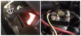

Getting closer to finnishing the loose wires on my bike. I suspect this wire that comes from engine bottom end, goes to the solenoid and attaches to the bolt on the solenoid. See picture.
does it come out of the area of the drive sprocket cover or is it bolted to the motor? If bolted to the motor then it's the ground. (Can't really see the picture well enough to tell).
It is coming from ca midle of engine, rear part and top of the engine block. This picture might help out more?
This is how the wire looks like when i pulled it out. If these pics still are too small to watch i can post it on Flickr to get larger pics with better resolution. After i come home from work.
the solenoid wire never goes near the innards of the engine. The black wire with eye-lugs looks like some kind of added ground wire but can't see much from these pix.

Thanx. Will get better pix and just upload to Flickr.
Do you know what wire will go to the bolt on solenoid? And where that wire comes from? I can?t see to find any that suits that bolt.
The wire that goes on the solenoid mounting bolt is the ground for all of the electrical panel. It should be black with a white stripe and go into the harness
If that black wire connects to ground, you should be OK
The striped wire in the first photo (green/yellow?) is the trigger wire for the solenoid. It goes back up to the starter button
Yeah that looks like an added ground (earth). On my 1000's the large starter wire goes from the solenoid through the back of the sprocket cover. Does that sound correct guys?
Do you know what wire will go to the bolt on solenoid? And where that wire comes from? I can’t see to find any that suits that bolt.
Those BIG bolts are for BIG red wires. POSITIVE. + One from the battery, and one to the bolt on the starter.
The black wire with the yellow covered lugs MAY have gone to the starter motor. That's my suspicion .It's not an OEM wire -that's for sure.
Have a look down at the starter motor and see if there's a wire attached!
