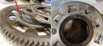

Hi, I'm rebuilding a GS 1000E '80 and bought heavy duty clutch springs for the clutch basket.
Grinding the rivets and hammered these out of the basket.
Then it went wrong. The basket and the pieces fell on the ground when it came loose.
There is a small curved ring beneath the backing-plate. Is this the right way to assemble? (curved up).
And... can I re-use the basket with those grooves?
