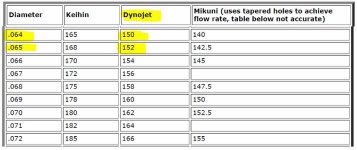

I just did some "minor" carb work (replaced the needle/seats, bowl gaskets, readjusted floats) and decided to take the opportunity to re-jet. Bought the Dynojet 150s, and opened them up (VERY carefully) with a 1.65mm Jet Drill, which turns it into roughly a 152.5 or so.

Dynojet jets are measured by size, so a 150 DJ jet is 1.50mm, therefore you have just drilled your jets out to 1.65mm, or a 165 main jet!

Sorry, but that's not correct... 1.65mm = 0.0649"
A DJ150 = 0.064" = 1.6256mm (1.6mm)
A DJ155 ~= 0.0665" = 1.6891mm (1.7mm)
A DJ165 ~= 0.0715" = 1.8161mm (1.8mm)
So, a 1.65mm = 0.6496 = 0.065" = 1.651mm, so between the DJ150 and the DJ155, hence, ~ 152.5.
I own jet drills from 1.6mm through 1.8mm, and verified the sizes prior to drilling. All coincide with the cross-reference charts.

I just posted all the information above. According to the Cross Reference charts, and to actual measurements, a DJ150 is NOT 1.5mm... It's 1.6mm, just like the cross-reference chart indicates. And, the DJ155 is NOT 1.55mm, it's 1.7mm, which is what I physically measured mine to be.

I contacted Dynojet and they confirmed that a DJ155 IS 1.55mm, as you suggested, so it's not that I don't believe you. It's just that the actual jets didn't measure to these numbers.
Either way, the Jets I have now are working, so that's what really matters to me. What they are suppose to measure, and what they physically measure, seems to be at odds with the sets I have.

if you look closely at a DJ main jet they are slightly tapered, or "venturi machined" as DJ like to call them.
This can understandably lead to inaccurate measurements

Sounds reasonable. Well, what I have now is physically sized between a 150 and a 155, and the bike is running cleanly, so I'm going to go with that for now.

Agemax, I owe you an apology based on the information we exchanged yesterday. You got me thinking about things, and so I went home to double check and, though I'm confused as to how my physical measurements were so off, YOU WERE CORRECT! 1.65mm was chosen based on that Jet Comparison Chart, which seems to get referred to here and on other sites a LOT, but it's physical diameter measurements are INCORRECT in regards to the equivalent Dynojet offerings.
As you stated, the DJ150 = 1.50mm, which is 0.059", not 0.064", as the chart shows. Same for the others.
Everything I was calculating was based on that chart, which clearly is incorrect for the DJ sizes. So, you were right... 165s were what I had in there. Would have been a disaster trying to head into the mountains.
Please forgive my ignorance. I rejetted back to the 155s last night. That, combined with the correct float levels seems to have put the mixture very close.

No worries Darin, just glad you got your bike sorted out finally.
