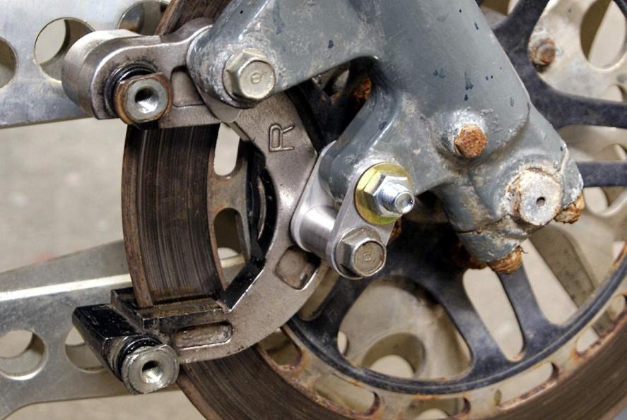

                  Test fitting the "new" (Suzuki/Tokico) one. I didn't expect its bracket to bolt up directly but the upper bolt is pretty close (there is no clearance between bracket & disc but I can modify the disc I'll actually use for that).

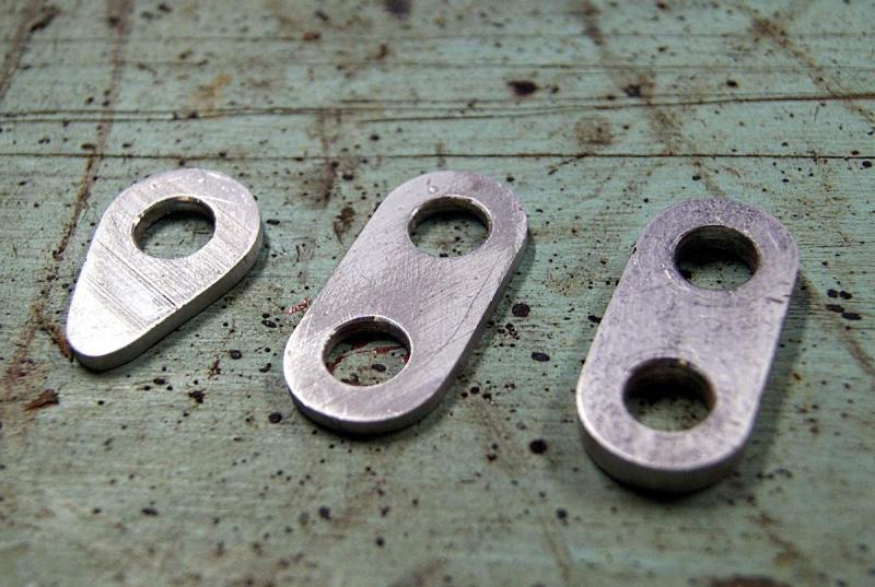

                    Here are the parts I made to attach the lower mounting points. 2 of them are links, the 3rd is a washer/spacer for the upper attachment made out of the same piece of aluminum as the thinner link. I left the tab to make it easier to get it into place during assembly.
                    Not shown is the 25mm long spacer for an M10 bolt I made on the lathe.​
                      When I put a bolt through the lug on the fork the bracket hit its head so I notched the bracket
                        Test fitting. I need to get a bolt the right length for lower fork lug and an acorn nut for it. With the bolts loose there is very little movement in the direction of rotation so this should work well
