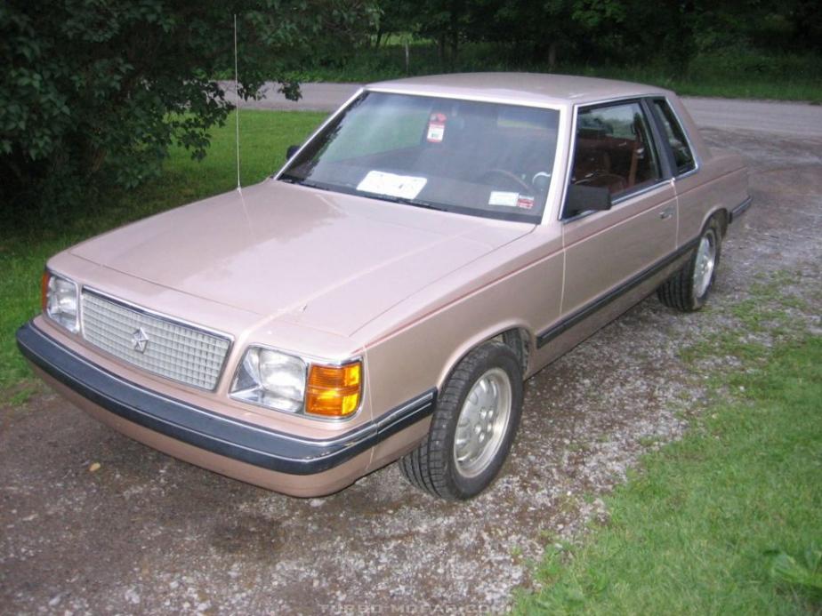

      The Only 4 cylinder Chrystler I'm Proficient in repairing is this type of motor...
      IN this type of car...
      I wish I had more pictures but I was very poor in 2003. All my money I had was dumped into that thing... Did manage to pull out a 12.8 1/4 mile time.
      But the 2.4 Neon/PT/Eclipse engine... I'm pretty sure it interference type. bet the valves are bent.
                        13.1 on 18psi. hope to have it back on the road this year after a 6 year hiatus while i fixed up my house and made babies bigger turbo, bigger injectors, i do my own chip burning, better intake, lsd in the trans, should be fun.
                        its not nearly as clean anymore either after sitting outside for a long time. oh well... makes waxing punks even sweeter.
